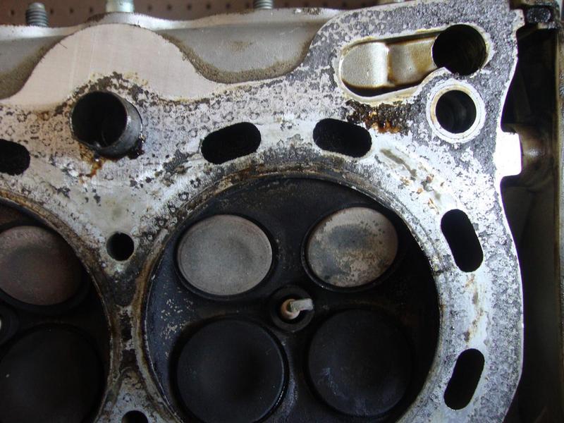

Here are the pictures of the head gasket failure on my 1995 Civic 1.5, non vtech.. This is the third one in 20k miles..

dude! what are you doing to burn through 'em so quickly??

Could be the block and head arent getting cleaned properly or the head is warped? Sucks to hear though

I bought this car from a friend.. He had the gasket blow on him..The engine got hot and overheated. Took it to a shop, they put in a new one, machined the head and 500 miles later, it blew again.. They installed a new one again and that lasted 19,500 miles. Then it started to bubble in the radiator, run not quite as smooth, and have exhaust gasses detected in coolant. So, he sold me the car (gave up on it). I just took the head off and see on the #1 and #4 cylinders, looks like a hole or pit in the gasket to the fire ring. I just purchased new bolts, gasket (oe gasket and bolts). I think they were either using a cheap gasket or not doing the job well. On this last time it blew, they told him that maybe a cylinder sleeve had come loose and caused it to blow.. (this engine doesnt have sleeves.)

There are only three things it could be that caused this headgasket to fail
1) Cheap/crappy headgasket
2) Bottom of head/top of block is not flat or has dirt on it
3) Improper torquing sequence (or stretched head bolts)
If all three of these things are done properly, the headgasket wont fail.
Being this headgasket was replaced twice before, I doubt the head bolts were replaced- so your going to need to get a new set. The ones to go with a ARP bolts, because of the high tensile strength material they are made of- it stretches less.

Generally, Honda head bolts don't have to be replaced because they don't stretch like other manufacturers head bolts do. But after this many failures, I agree with Triz. Change the head bolts next time you do the gasket. Take the head to a different shop to get checked out, and make sure the block is very clean when you reinstall the head.

you have to figure out why it overheats first. what happened the first time? it looks like that gasket was cooking. make sure you fix the overheating problem (thermostat, sensor, fans, water pump, etc) otherwise you will keep blowing them. is the temp gauge working?

Ahh yes if the car is still overheating after the head gasket change the head gasket will blow again.. Good call gearbox, I just assumed it was fixed

This last time it blew, it just started to run less smooth then it used to.. The temp gauge and fan appear to be working properly. Thats why I think they used a cheap gasket and hurried through the job. I am doing it myself this time and bought new bolts and oe gaskets.

I would get the block and head machined.
When you torque the first sequence, repeat the sequence a 1/4 of a turn at a time until you reach the proper torque value. This assures proper seating.
Also tap all of the threads in the block and use new head bolts, and put a little oil or engine assemby lube on the bolt threads.
And double check all of the cooling system thouroughly!

btw you may have to have your valves replaced it looks like you have some nasty pre detonation marks on them. Just wanna make sure it hasnt scarred the valve seats or piston heads man otherwise youll be ripping it apart again.
good point, missed that
