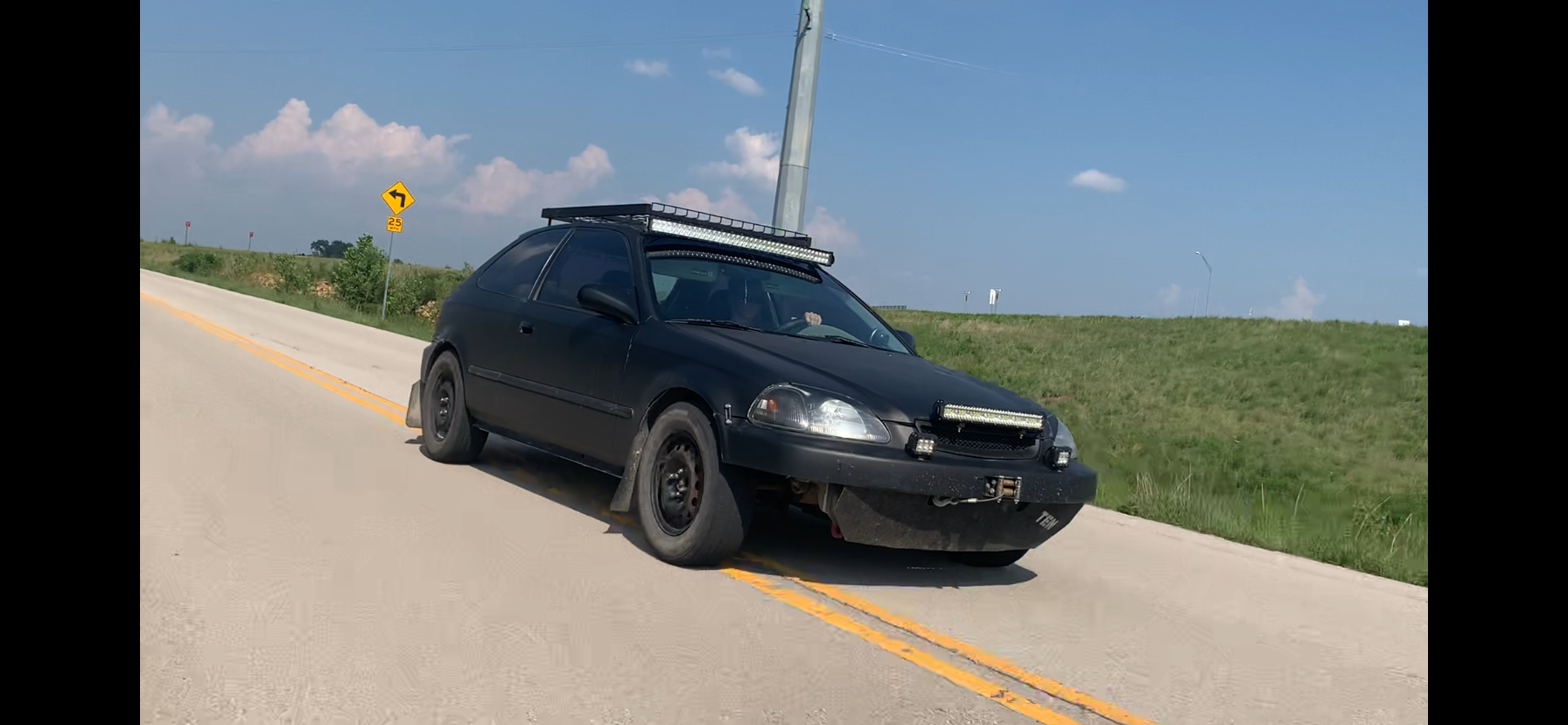

I have a 1996 ek honda civic with a stock d16y7 motor. I haul a lot of weight on a regular basis and have larger tires and do a lot of road tripping that require loading my car with camping gear. Are there any simple ways to give my car more torque for the weight without sacrificing reliability, top speed, or fuel economy?
