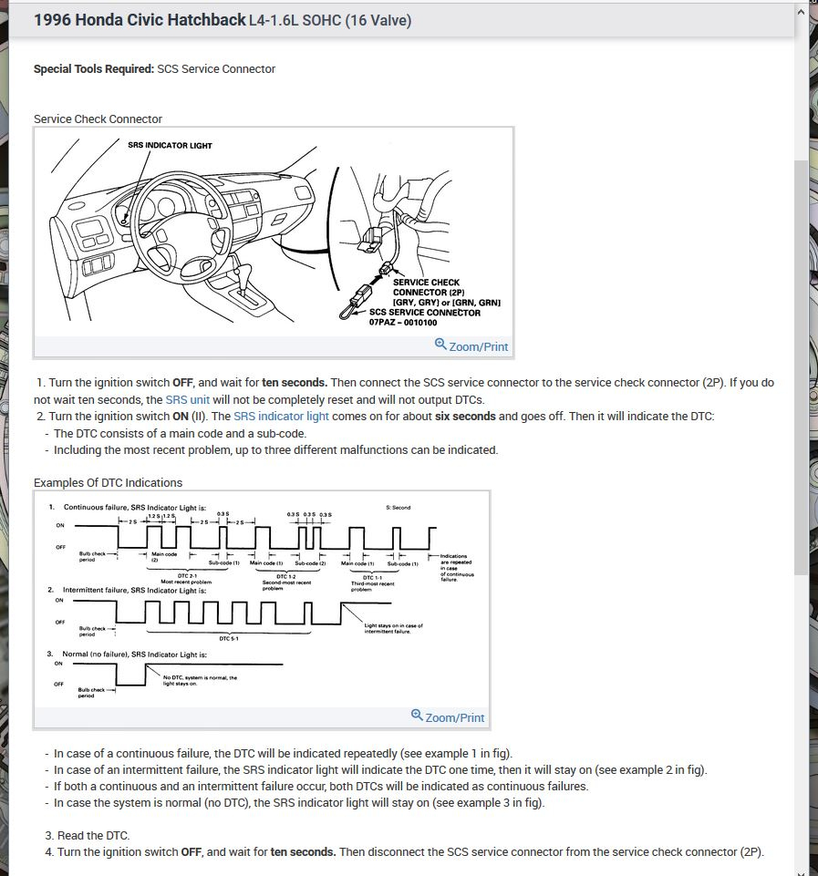

that's weird. for newer civics my computer usually lists a troubleshooting procedure for the DLC but it seems to be missing or non-existent for a '96
try it the old fashioned way?

Verify engine code and verify PCM part number
And try getting blink codes using the SCS method

I looked at my obd2 plug and the pins look fine, someone asked me if my dome light worked which it doesnt I know they r on the same fuse under the hood. I put a new fuse in just for ***** and giggles and still nothing. Haven't had the time to do the old school paper clip trick yet
