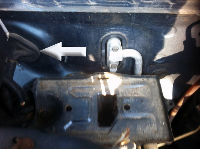

I have a 96 Civic and I've been reading that if I remove my battery, there is a hole I can run my amp power wire through from the battery. I took my battery out, and here is the pic, and I don't see where I'm supposed to wire it through. Or if anyone knows another spot I can wire it through that'd also be great.

There should be a hole in your firewall you can run it through..i would look under your dash for a plastic or rubber insert that comes out..you can run it there...

rubber boot in the left side of your picture

Just cut an X in the area with the most space and angle down as you feed through.

^ or go there..since that was what you asked orig..

In my 97 there was a grommet and hole preexisting on the passenger side where your feet go, a little ways up. I just used that.
