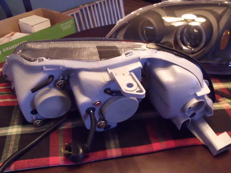

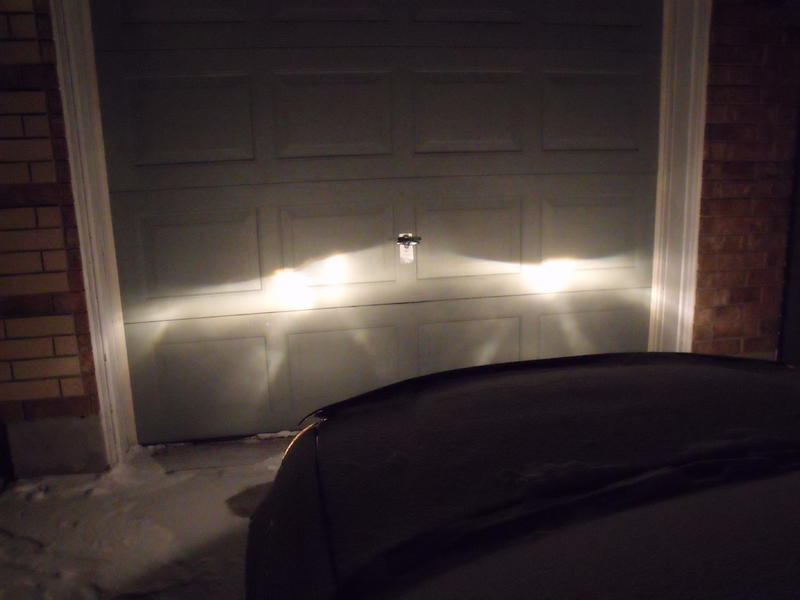

I bought some projectors off ebay...installed them in my 98 civic hatch and now i cannot get them adjusted properly, im aware of the euro and dot style cutoffs mine has dot cutoffs. The problem is the projector lensese seem to both be rotated counterclockwise slightly, proving it impossible to get a nice cut-off. I will be posting pictures later of the pattern when it is darker, please reply if you have had this problem or know how to fix it.

change the projector to a real one from an oem car. or even hid. those aftermarket units are terrible and have no regulation. rotational adjustment is not possible, they are mounted on two solid screws and a third anchor. most you can do is up/down and possibly left/right. no rotation.

is there any way to swing the cutoff plate to even the beam....i noticed theres one screw that it mounts onto...?

you can try but that looks like a mess. i dont even know if you can level something that looks like this \/

Good luck fixing that. The only viable option would be to crack open the lights, then adjust either the projector mounting points or the cutoff plates. In both cases, you probably won't be able to get it exactly level unless you build a mount.

thanks for the help guys, great site.....i am new to this but new to civics ;p....i think what ill do is roll up in my shop floor and loosen the plates (the screw is right inside the bulb holder) in the hope that they will fall level, might be too hopefull, but will post pics (if this works) for anyone else who cheaps out on ebay projectors ..... like me

sorry cannot post pics, digital camera is not working at the moment, i took apart the headlights (in the oven) 200 degree chut off the oven, put headlight in for 10 minutes take apart... a few brackets were bent incorrectlly inside so i straightened them got them somewhat lined up....i will be tweaking them again in the summer-time as i cannot get it done correctlly inside my gaeage i will post pics of another fix later on, until then....good luck
