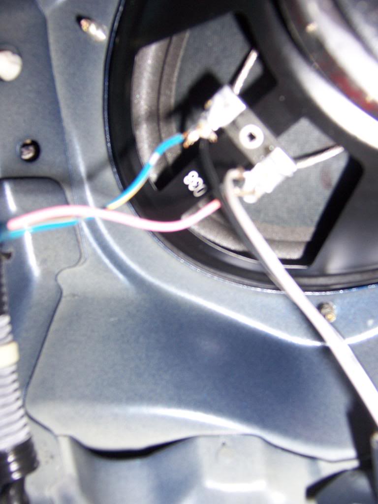

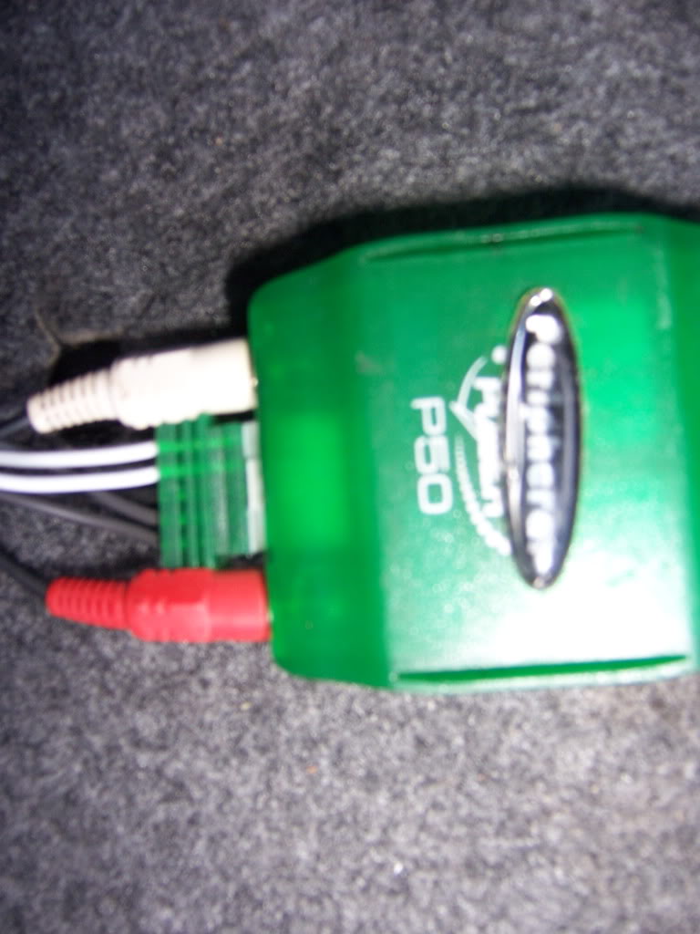

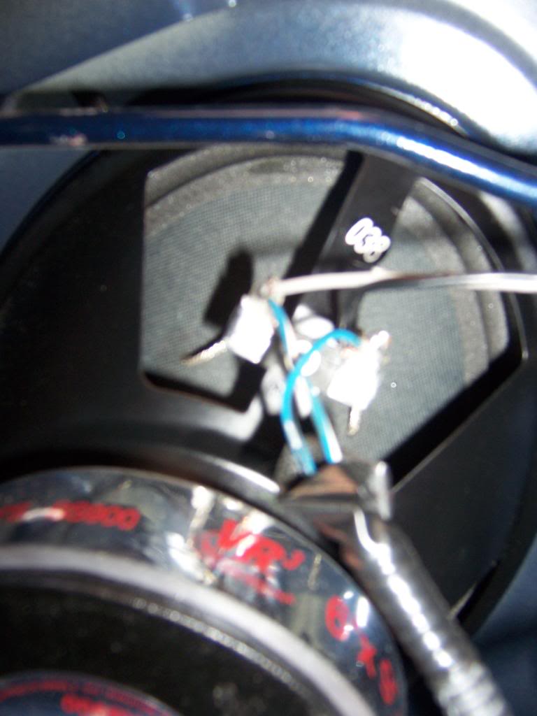

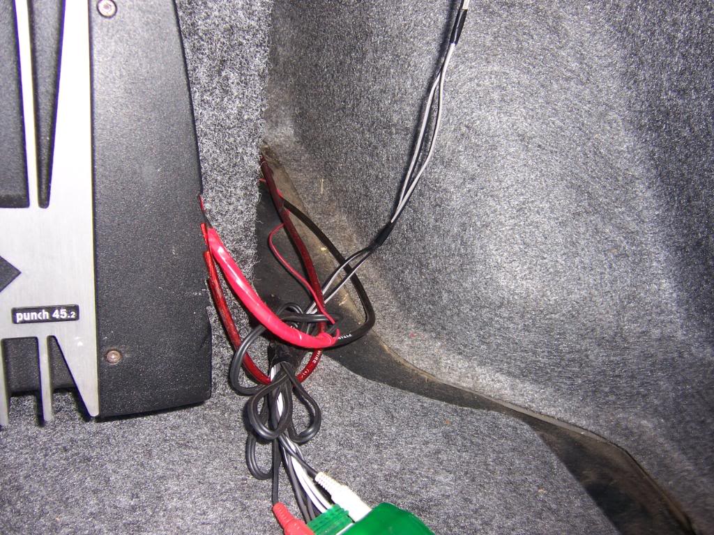

To keep your stock HU (if this is what you ment by a line out converter my bad) you can tap your rear channels, I just did this because I didn't have the Sub wire to run from my HU to the back, so I can't control the volume from the HU but I still have amp controls.

Thats the RCA converter box

Left Channel Tap

Right Channel Tap

Pulled out, the lines going down and the cluster tape wrap. It would be cleaner to show if I took the amp plate off.
All together for my subs, it was $100, running the wires wasn't bad, but there was a lot of extra wire in my uncle's garage, 2x MTX 10"s with a punch 45x2.
