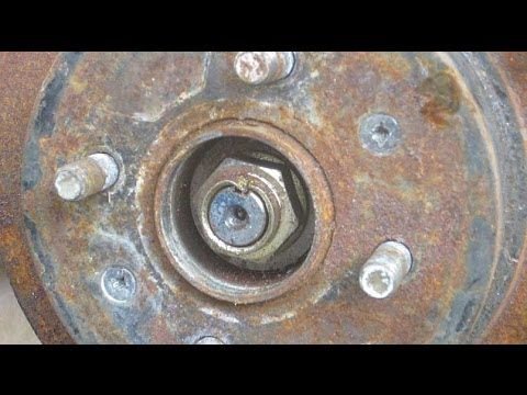

Axle nut is usually staked in place. Take a chisel, punch, flathead screwdriver and a mallet/hammer/banging tool of choice to unstake it. From there, you can take that bad boy out. I'll do some searching to show you what it'd look like.
Edit: prolly not a civic, but same idea.
see how the axle nut is dented in place into the slot on the outboard end of the axle? Yeah, that's a staked in nut. Undent that part and you're home free, provided you have a 32mm/1.25" socket
Edit 2: as far as cotter pins go, yeah, just ball joints and tie rods, iirc. It's been a minute since I've tinkered with those. Tie rods for sure. Like 95% sure on the ball joint one.
