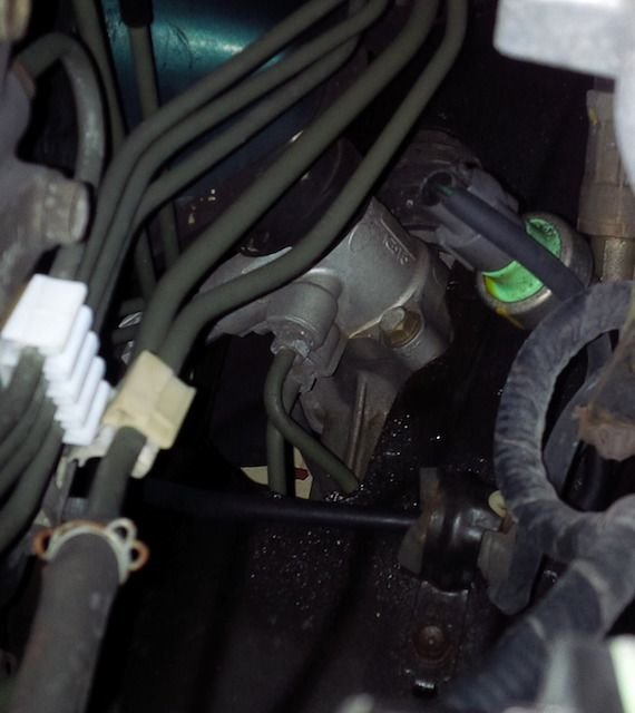

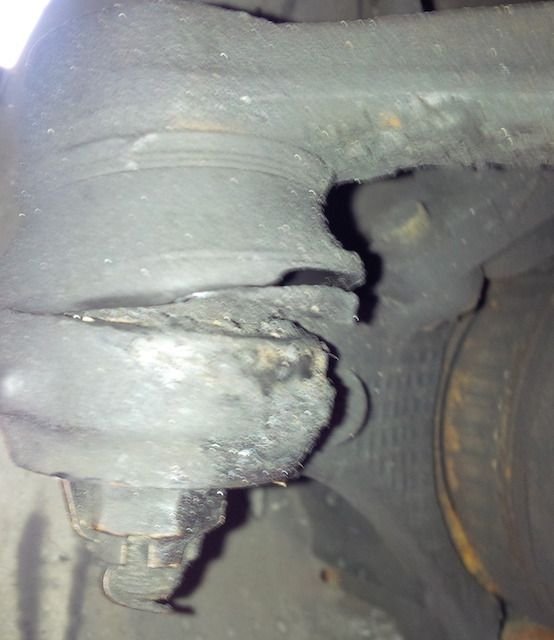

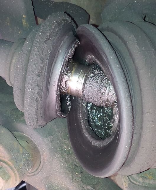

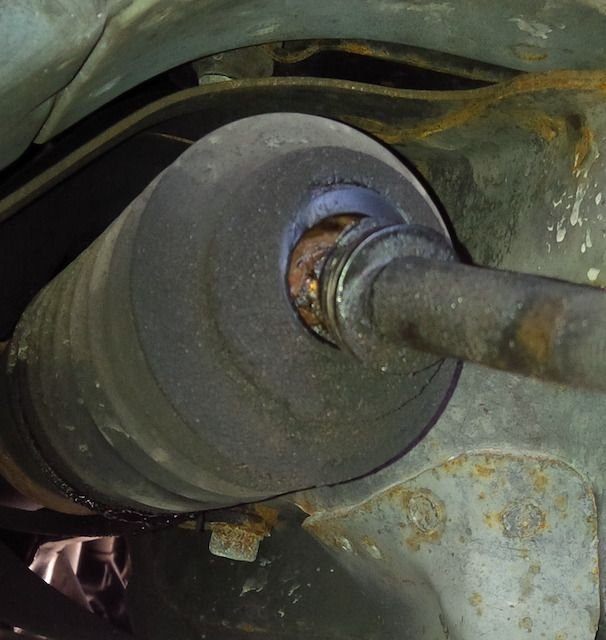

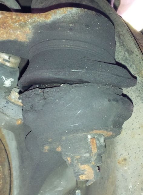

Hello all,
Recently, got new tires and went for alignment but was told they could not do it because both inner tie rods need to be replaced; I plan on doing outers, while down there. Shop also said I need DS axle, which I can hear clank, when I turn. That said, and I don't know if it's related to the tie-rods and/or axle but I also hear a loud humming noise, as I accelerate along with occasional sounds of metal scraping, in circular motion. I don't hear, in idle, it gets louder as I accelerate but disappears, when I turn left.
I appreciate you thoughts.
Inner TRE DS
Inner TRE PS
Outer TRE DS
Outer TRE DS
DS Axle:

Boot tears, grease leaks out, part wears out. Might as well plan on replacing the inner tie rod as well. To check inner tie rod..once the outer is removed grab the inner tie rod shaft and move it in multiple directions..it should move but not easily. If it moves easily or sags down after you let go of it, it's worn out and needs to be replaced.
Advisable (but not mandatory) to replace both sides left and right inner and outer rods at the same time. Conventional thinking is: If one side is worn it won't be long until the other side is worn out. Ties rods and boots are inexpensive and in-addition to the service manual there's many youtubes and DIY write-ups on how to replace them.
As far as the CV axle: Find an empty parking lot and do full lock-left and right turns (donuts)..listen for clicking and/or knocking during turns. If knocking or clicking replace offending axle(s)
The rotational scraping you are hearing is most likely the front brakes dust cover. The dust cover is directly behind the brake disc and can get bent forward causing it to scrape the brake rotor. Easy fix..just bend the dust cover back where it's contacting the brake rotor.

for how cheap a new axle is you might as well get a new one, and the nut.
Like Megalodong said best to both sides at once for the inner and outer tie rods

To clarify, because my thread Title doesn't, I plan on replacing inner & outer tie rods on both sides. In which case, some have suggested to go ahead and replace the steering rack, which includes both sides. That said, my main concern here is diagnosing the loud humming noise, while accelerating that disappears, when I turn left as well as the rotational metal scraping noise and whether or not they're related to the tie-rods and/or axle. Some have suggested these could be wheel bearings and/or hub.
Is there an issue with the steering rack? Any power steering fluid leaking from the rack? Replacing the rack can be tedious and time consuming. Start with replacing all tie rods first unless there's a known issue with the rack itself.

No issue with the rack itself, that I'm aware of and not sure, how or where to check, if power steering fluid leaking.
Does power steering fluid disappear? Do you ever have to fill it? If no, and the fluid is at the correct level, then it's not leaking.

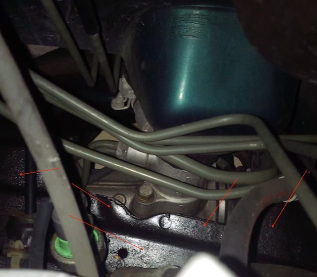

From what you all have seen, in my pics and based on my description of noises, how comfortable would you be driving this car another 500 highway miles?
Old Dec 24, 2017
Posts: 15,179
Likes: 1,606
Rep Power: 367
Re: Replaceing inner & outer tie rods 96 civic ex
the humming noise is quite likely the wheel bearings.
when you lift and do the test, if there is too much play, I would do as soon as possible. while humming, they should still last some time, but don't abuse.

3 & 9 could be the tie rods, 6 & 12 bearings or ball joints, but since humming, I would point to bearings. when changing the bearings, you will need to remove the ball joint, i think, so you can inspect it too, or use a prybar now to check if too much movement on ball joint
not sure, but if bearings pressed in, you will need a press or someone that have a press. (that how it is in my 7th gen, not sure on the 6th.

From what you all have seen in my pics and based on my description of noises, how comfortable would you be driving this car another 500 highway miles?

FWIW: Decided to play it safe and not take the 500 highway mile road trip. That said, I'm in agreement that the noises are related to wheel bearing and/or hub and in either case, replacing hub. Now, attempting to rule out PS rack issue or not. Here are some more pics of what I believe are rack and inner TR boots, where they meet rack.
Thoughts?
Old Dec 26, 2017
Rep Power: 518

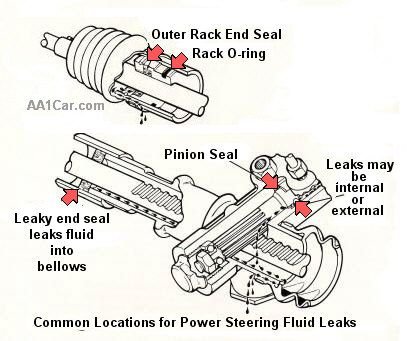

Boot split wide open, yes replace it (both?)
You'll need new clamps for the large end of each boot....I'm not sure if you need the wire coil for the small ends or not.
If you're trying to judge leakage...... How much fluid have you had to add to the PS (total amount) in how many years and miles?
Any fluid loss that didn't leak externally went into those two boots....and there will be like 22 years worth of normal seepage...but is it losing fluid at a rapid pace?
Will it leak a lot in the near future?
Does it WORK right now?
Do you want to risk a cheapo parts store reman rack?
We can't really judge how bad the wheel bearing noise is...... No way to know how long it might last, no way to know how bad it can get before disaster either.

Leakage....look inside at the firewall area where the steering column goes through, see if you can see signs of leakage from the top seal of the steering rack there
Any other rack internal leakage would have collected inside the boots that are now split open....and HOW LONG have they been open and exposed to the elements, collecting dirt and road debris? (MAYBE that's reason enough to replace the entire steering gear?)

...Leakage....look inside at the firewall area where the steering column goes through, see if you can see signs of leakage from the top seal of the steering rack there...
Thanks!
I assumed you meant look inside the engine, not inside the car.
From top, I did notice moisture, in the areas marked with red arrows but not necessarily on the wall:
Side view:
You'll need new clamps for the large end of each boot....I'm not sure if you need the wire coil for the small ends or not...
Thanks!
At this point, sounds like I can't avoid having to take off both sides inner boots, to see how much damage the elements have done to inner TRs, in order rule out whether or not PS rack is needed vs boots & inner TRs.

Yeah, whatever. I meant look for pinion seal leakage, wherever that may be.
I gave up trying to remember all the minutiae of all the various cars I don't ever see anymore. Most of what I see is maybe 15 years old and newer, majority is less than 10 years old. (I can't even remember the ones I see all the time now as it is!)
The oily residue mess in your pics, what's the source?

...The oily residue mess in your pics, what's the source?
Pinion seal leakage??
Old Dec 28, 2017
Rep Power: 518

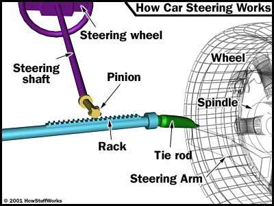

It didn't really look like it came from the steering itself, like the mess was left by something else. I can't see it up close though.
Pinion seal. Leakage.
Rack And Pinion steering
And if this 3rd image will embed.....
