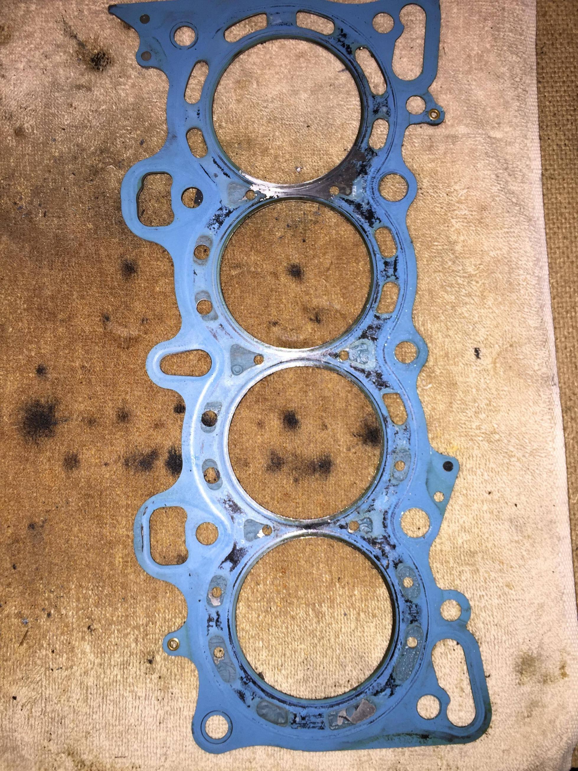

got everything taken apart today. Tried to be extra careful of the knock sensor like Turd recommended but unfortunately when I was cleaning the intake manifold I noticed that the knock sensor had broken.
So I'll pick up one of those tomorrow and hopefully get everything put back together. The "good" news is that the fel-pro gasket clearly failed. I hope to get a picture or two put up when I'm done. The blue sealant/layer of the gasket was worn away around cylinders 1/2. I checked that everything was plumb with a straight edge and a .003 feeler gauge and everything felt pretty good. I went with the OEM Honda gasket this time and hope to have better luck, only got around 21k miles out of the Fel-pro on what I'm convinced was a good install.

Well I wrapped everything up last night, thanks to the help of everyone here that chimed in. Started it up and everything seemed smooth. Ran it to temperature with the radiator cap off and didn't get any bubbles after the lines had all bubbled the air out of them.
So hopefully everything is good to go now, won't know for sure for a few weeks I imagine. I took a photo of each side of the old gasket. Sorry for the bad lighting and cell-phone pic but hopefully it helps someone in the future who installed a fel-pro gasket only to have it fail.

Old Feb 12, 2016
old97civic's Avatar
Joined: Oct 2014
Posts: 123
old97civic is an unknown quantity at this point
Re: Recommend me a new head gasket?
Interesting how the openings are not the same for each cylinder. At one end there are 6 "slots", the next has 2 slots and 2 holes, then 1 slot and 3 holes and finally only small holes at the opposite end.
Old Feb 13, 2016
Rep Power: 518
That's to control the circulation of coolant through the block and the cylinder head areas.
