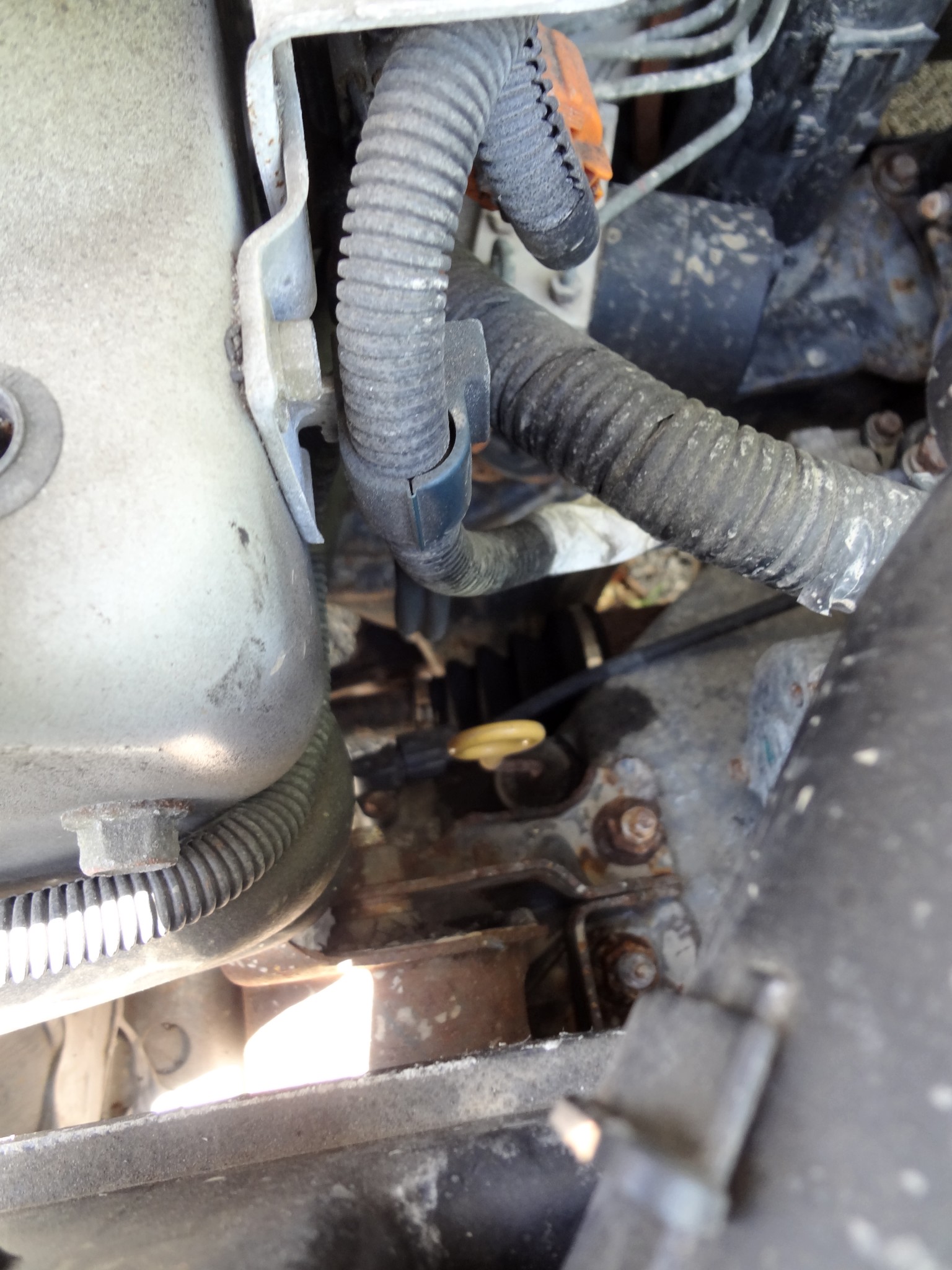

Hi, I have a 1996 Civic LX with about 45,000 miles, and I want to replace the automatic transmission fluid, since it's never been done on the car. I've never done it before, so I wanted to make sure that I know the right plan before I start.

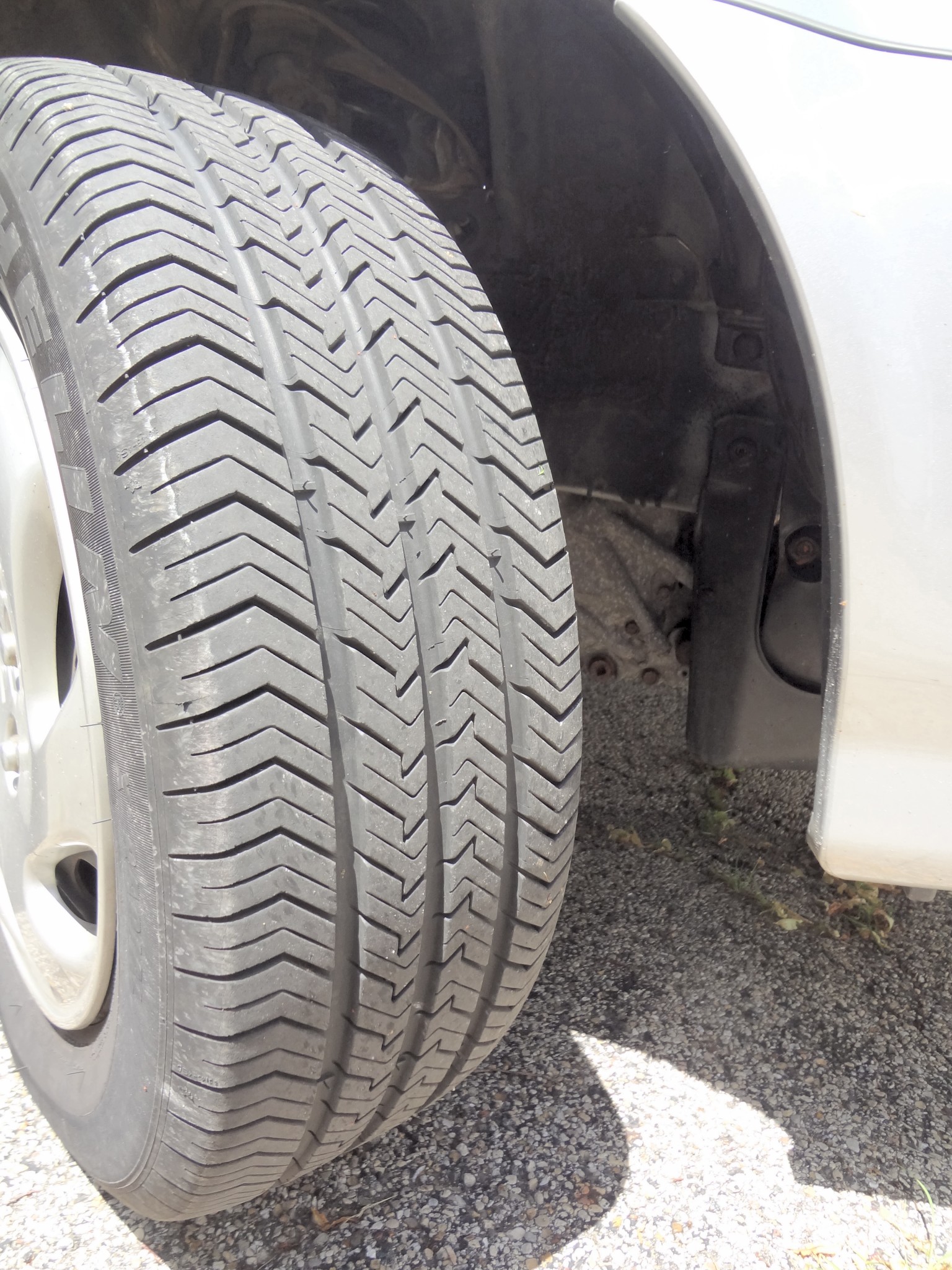

I'd heard that bolt for the the drain pan is on the right side, and if you turned the wheel far enough, you can actually see the square-headed drain plug.
My questions are:
1.) I have 3 quarts of Honda genuine ATF DW-1... This is fine to use, right?
2.) Is it possible to access the drain plug and drain the fluid simply by turning the front wheel far enough? Can I get away with not having to jack up the front of the car or put it on the ramp?
3.) Is it okay to reuse the crush washer of the drain plug as long as it isn't badly deformed?
4.) For refilling the ATF, I remove the stopper with the rubber gasket on it and pour the fluid in a funnel placed in the top of the same opening, right?
Anything else I should know?

1 yes...and it should hold about 2.5 quarts (Fill it, run it, then check trans fluid level with the engine OFF)
2 looks in your pics like you may reach it
3 I do it, but that doesn't mean everyone should LOL
4 make sure you have a funnel that will reach the hole first
That plug can take a lot of effort to break it loose, I've broken a Snap-On ratchet on one before
Make sure the square of your tool fits all the way into the plug, you may need to scrape dirt out of the hole first
Wipe all the fuzz off the magnet when you get the plug out
HTH
