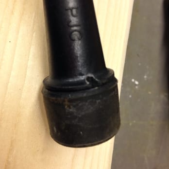

If the plug wires are the type that have a rubber boot on the tip of a plastic tube, they can leak spark between the boot and tube. They can leak spark right through the side of the tube too.
Danger! I do this, I ain't skeered.....With the engine running, I will lift up the plug wire off the plug but not all the way out of the hole, and look down inside. Usually you can see if the spark is coming out of the end of the wire or if it's coming out the side of the wire.
(If this test kills the ignition coil, then the coil was already bad and needed replaced. Better to fail now than to be stranded somewhere at the worst possible time.)
I've found better examples than this but not today LOL
Ooh found one
Pinhole burned thru the tube, spark leak:
Then I might pull the plugs and look for arc trails on the outside like this:
If you do find this, you MUST replace the affected plugs AND wires at the same time. If you don't, one bad part will ruin the new part.
Ooh found one
