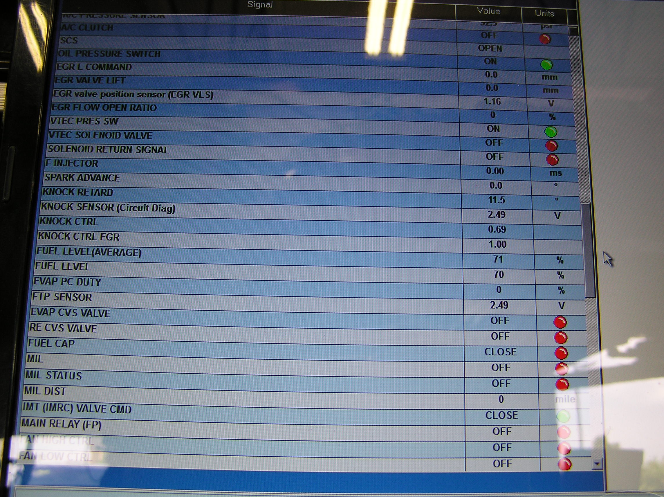

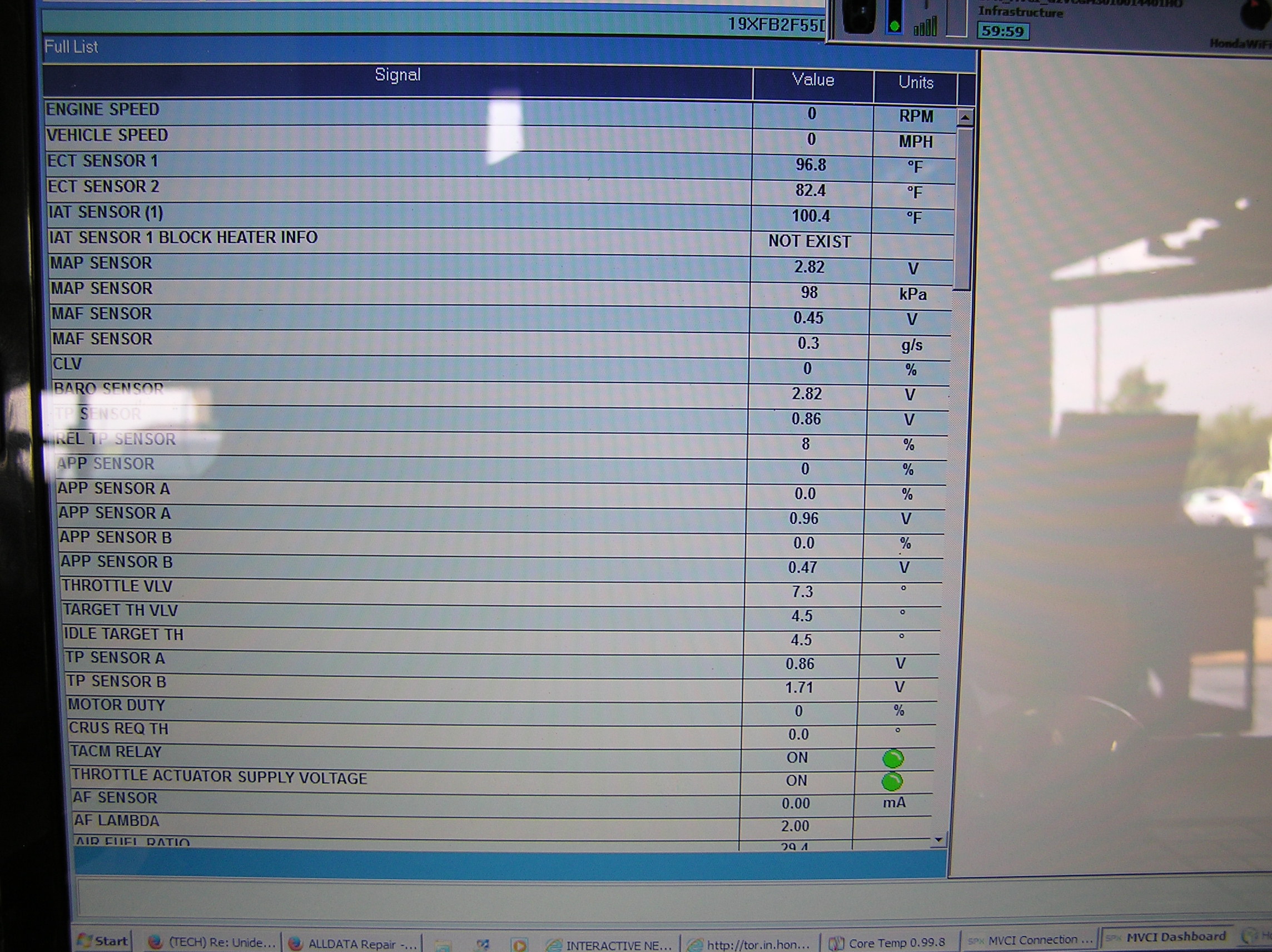

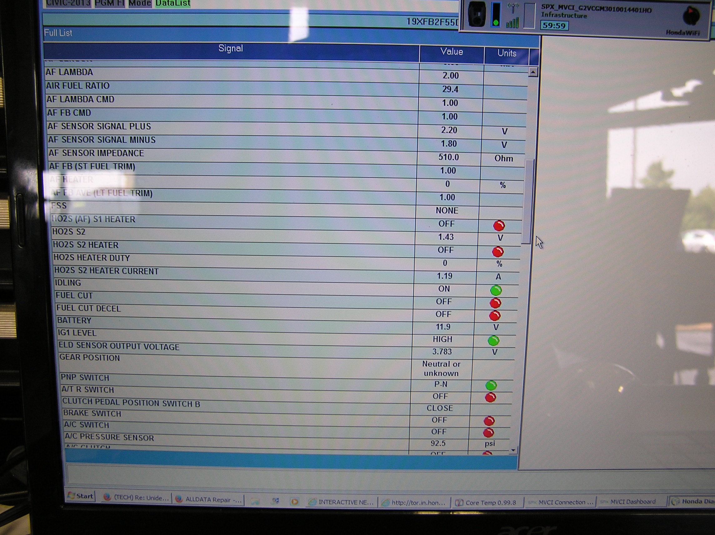

Here's some pics of the HDS scanner program I have available as a dealer tech, this is just a portion of the data list available on a much newer car
(I think this might have been from my own 12 Civic)
Dialup warning ahead!
Note that this is showing a data list from a much newer car than yours, this probably has at least 5-8x the amount of data available than yours would.....and it also depends on the scanner you have available, most aftermarket units cannot give all the data that a dealer level scanner has available.
(I'm sure that the engineering departments have access to even more data that we can't really make use of in the field too.)
