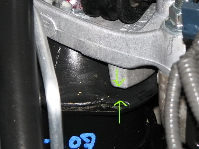

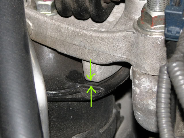

Looks like it's collapsed. There's little or no gap between the upper and lower halves.
Compare to these pics (courtesy of Gunner)
Bad:
Good:
HTH
Old Sep 8, 2014
Re: 08 Civic idling rough, shifting late
Originally Posted by 193drtelco
I'm having the same problem with my 08 POS. Motor mounts, transmission mounts were all replaced.....they were all bad, but I still have a terrible vibration. It is a bit better, but it seems the vibration will damage the new mounts in no time....any ideas?
Throw away the aftermarket mounts.
Install factory mounts.
I've not yet seen any of these cars that needed any more than the one at the nose of the engine anyway, pictured above.
