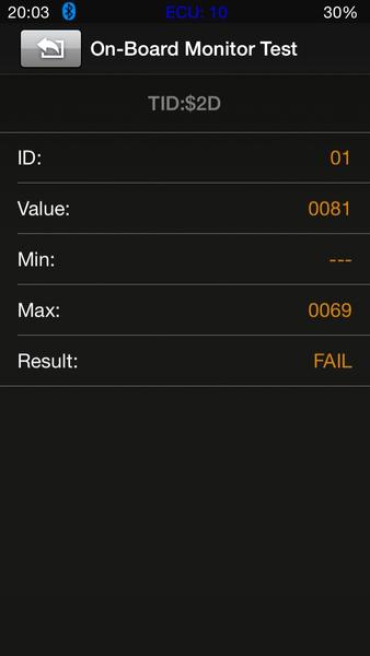

Ok back again with this problem, the car has been parked for months and today I I drove it with my scanner and ran Mode 6 testing. Here are the results.
Old Apr 6, 2014
  #40
Re: 1998 Civic EX Evap System Question
More Secret Decoder Ring stuff?
Unfortunately lol
