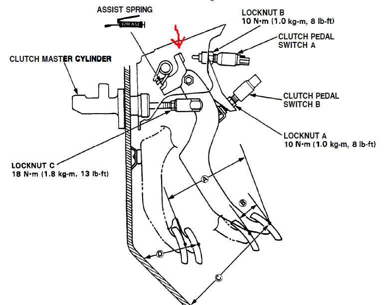

Apparently these like to crumble the rubber pad that contacts the clutch switch, that keeps the plunger of the switch from getting pushed in all the way.
Old Jun 9, 2013
Re: Won't start
Not from your car, but I found a pic with the general idea:
