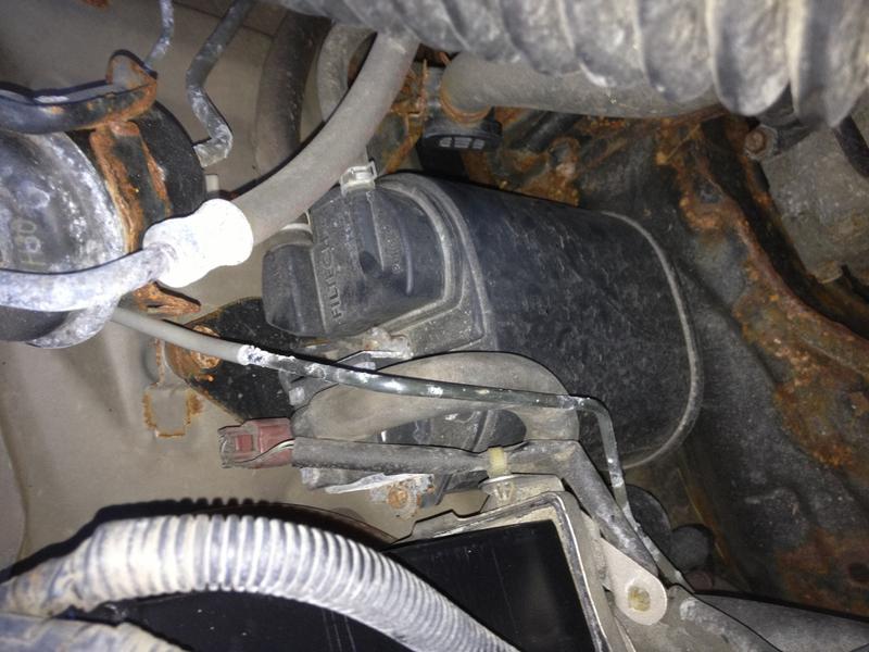

Up from the dead. I am also struggling with the p1457 code.
Except I think my canister and everything is under the hood not back by the gas tank.
Does that make sense?
2000 civic lx
@ezone;
Old Aug 1, 2013
Re: P1457. Please help!!!!!
Originally Posted by MyDDtheHONDA
Except I think my canister and everything is under the hood not back by the gas tank. Does that make sense? 2000 civic lx @ezone;
Canister is under the hood, sure. But there are still several important items back at the gas tank area. What they consider to be the Canister System includes many of those items. Read that bulletin that was linked in the earlier post, but remember there are more possibilities than just that mentioned in the bulletin.
