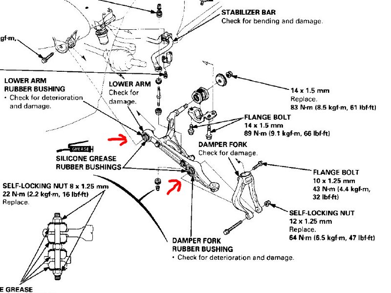

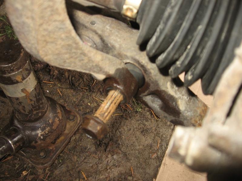

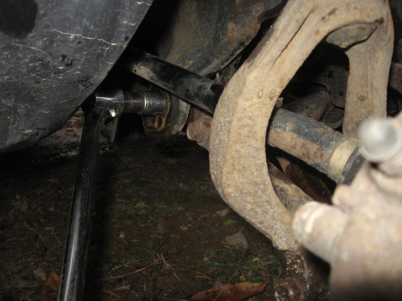

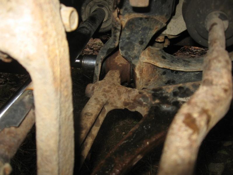

The squeaking thing started happening to me about a week ago. It went from just occasionally to pretty much constantly over the course of a week. I had actually done a full suspension inspection last week to make sure tie rods ends, ball joints, ect were OK....and they were. So I didn't really care about the occasional squeak too much...hey my cars 15 years old it's bound to make some noises.
When it became constant over the past couple days it really drove me crazy. So long story short all I ended up having to do to fix it was lubricate my lower arm bushings. It actually points that out right in the FSM. If you don't jerk around at it like I did it probably only takes about an hour or 2 to get it done. A breaker bar is handy for the inside bolts as well.
