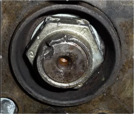

5. Remove locknut (center of the hub where the end of the axle is). You have to bend out that tab before you can remove it.
It'll look like this:
