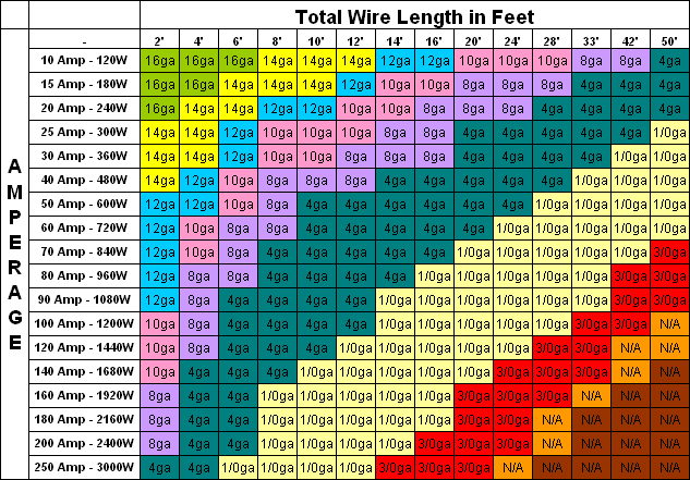

here's a good chart to give you guidance. You'll highly likely be dealing with the first two rows, and I'm guessing you're not going to exceed 10 feet of wire

thank you for your reply. The kit sates the working current it 15mA. Wire may be 4 meters long.
