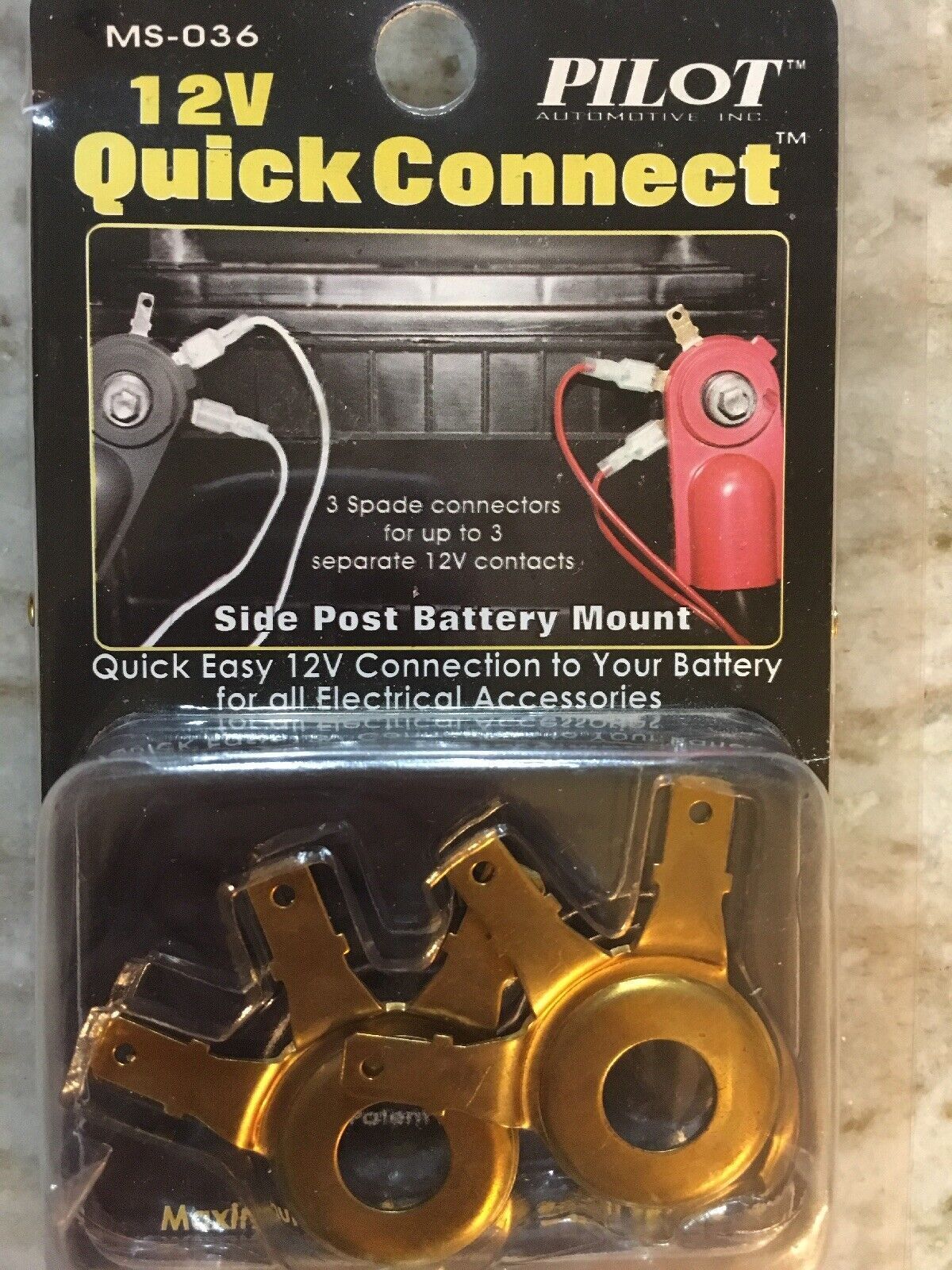

How about running a wire direct from the battery with an inline fuse? It's not near the stereo, but the firewall penetration for the engine wiring harness is in the passenger footwell and just takes stabbing it with a screwdriver to send wires out of the cabin. I ran a 2AWG through the thing for a stereo system and it still maintained weather resistance.
I used something like one of these (but for top post) for some aux accessories straight from the battery and just used some random closer proximity bolt to ground out the load. Zero issues doing that
