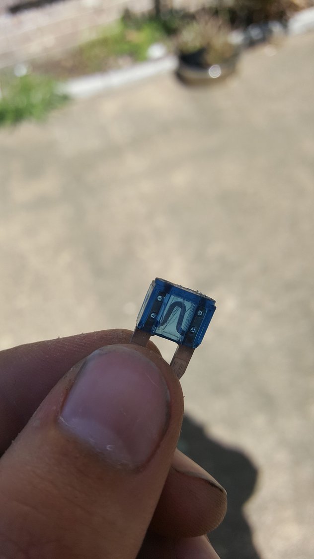

"small lights" fuse opened.
Isolate any wires tied into illumination.

this is the fuse.

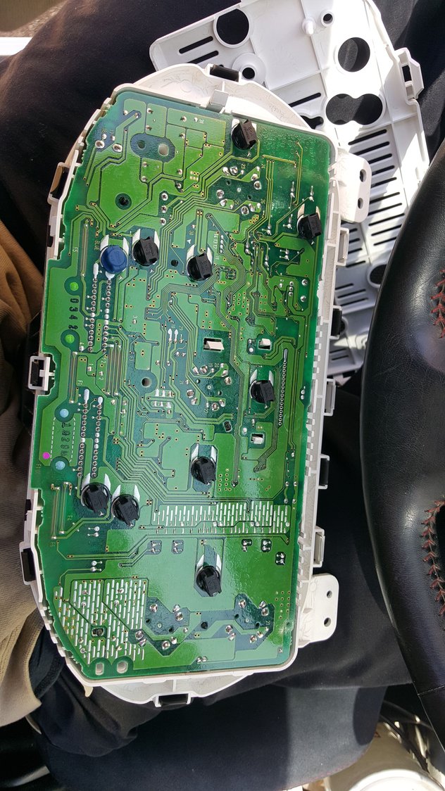

this is the cluster. No burns or smells of burnt .

Apr 9, 2018
Re: Dash Cluster Lights Stop Working
Quote:
I didn't check the secondary fuse box, though
Why not?
Disconnect the new radio. There are usually two (orange?) wires labeled illumination + or - on the afternarket and EZ adapter harnesses, make sure BOTH are disconnected from the cars harness.
Time for a good wiring diagram and a voltmeter.
If tail lights don't work, then the front parking lights should not work either....and if those are dead then the dash lights should also be out.
I'd start testing by checking any of the lights that don't work.....is power missing? Is ground missing? That answer determines the next steps.
If power is missing, I'd then move to testing at either the headlight switch or the taillight relay.
The wiring diagram is important here when it comes to figuring out what you test for, because the headlight switch does not control power to the lights...
Reply 0
