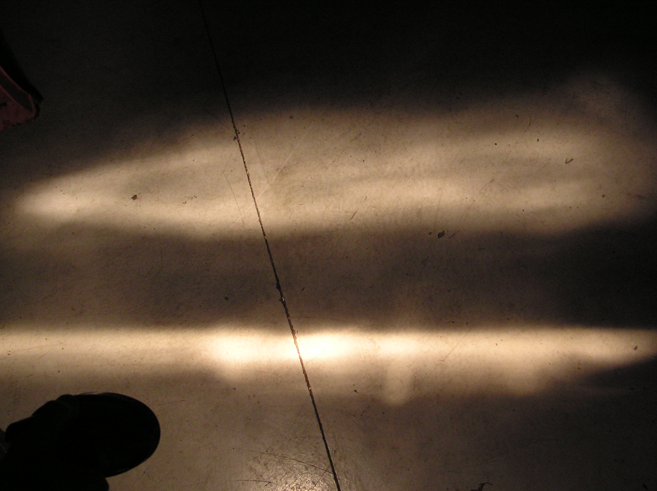

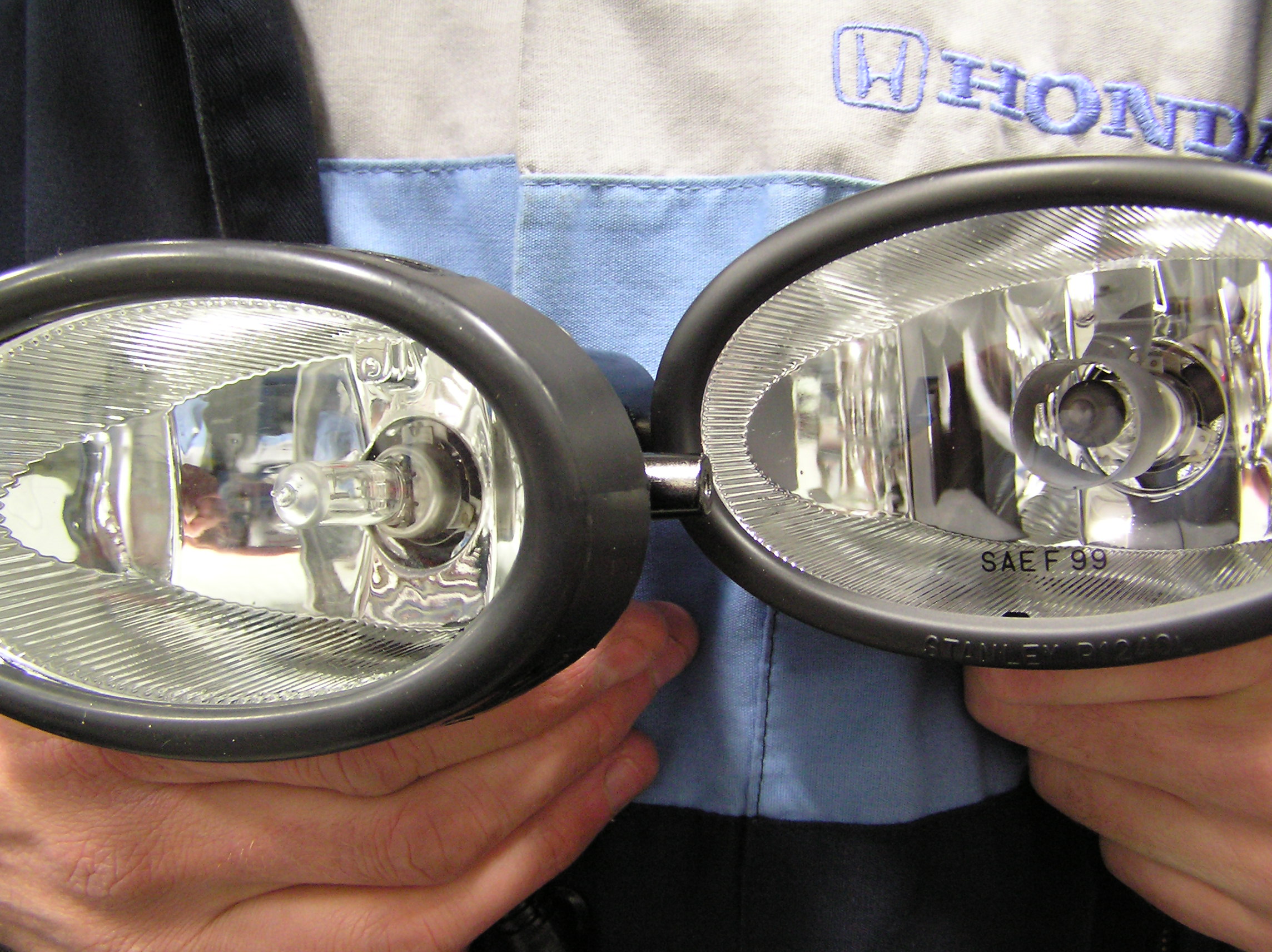

Ezone has a set of pictures comparing a brand new stanley unit to a brand new "china" unit and you can see the difference is very large.
Genuine Honda accessory says Stanley on it.
Top blur of light is the knock off.
Bottom beam is the Genuine light from Honda.
