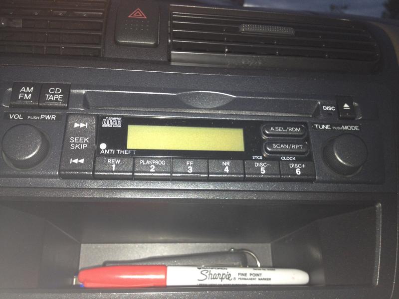

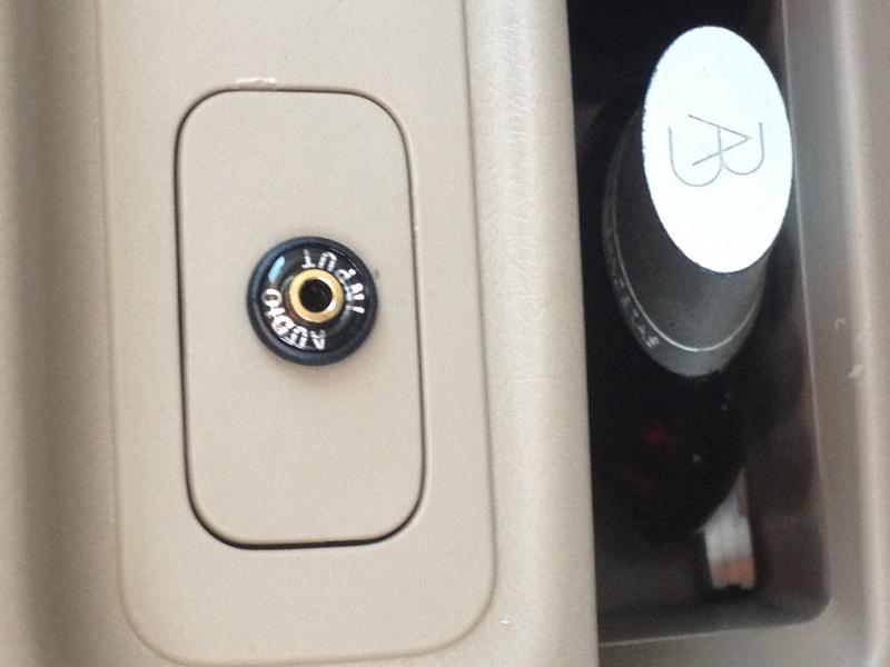

I just bought a 2003 Civic HX the other day, and I just noticed that there is an Audio input in the car, but no aux button on the radio. I'm not sure if this was an unfinished project? Or if I'm just missing something...

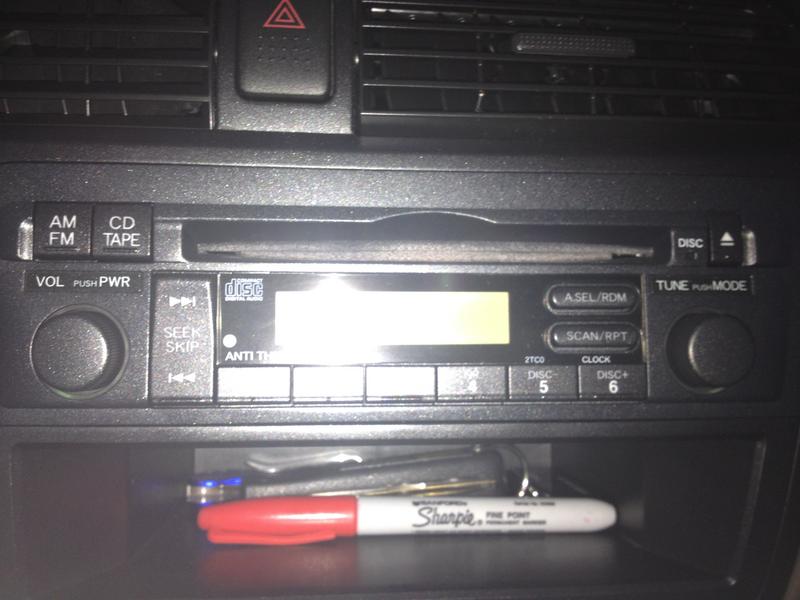

This def looks non-factory to me.
Is it wired into the radio or its harness now?

It could be an aftermarket kit plugged in through the cd changer port. Try pressing the cd button twice. After the second press it should go to "Cd-c" mode if its hooked up. Scroll through the Disc numbers and track numbers while music is playing on your ipod until you come to a combo that plays the music.
