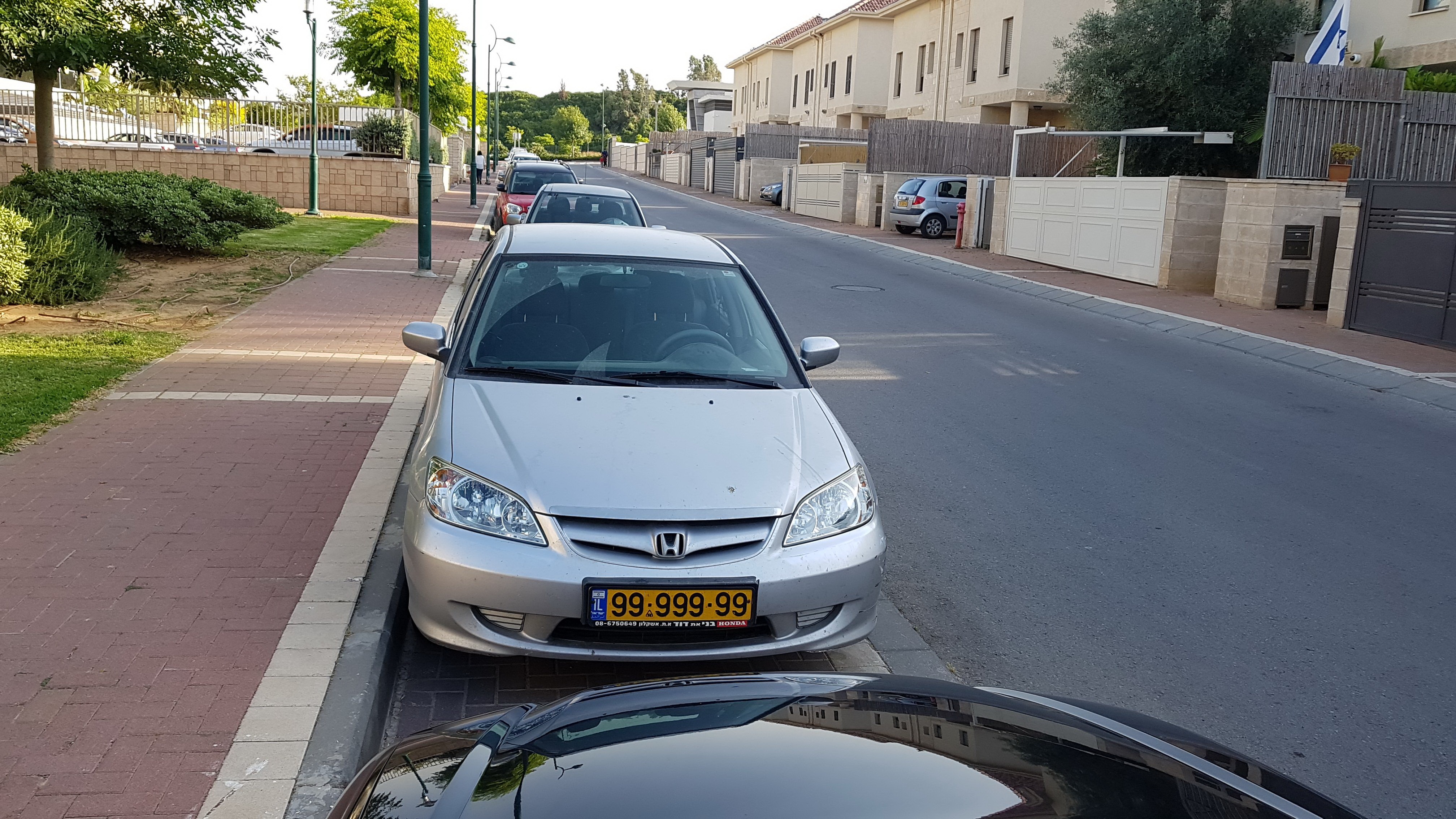

i am new here and i have the same issue with my led light's
i ordered 50pcs 7443 and 50pcs 7440 generic led light's from here: https://www.aliexpress.com/item/50pc...311.0.0.fS63uG
if i will use this kind: (https://www.ebay.com/itm/LED-Load-Re...53.m2749.l2649 ) of load resistor, one for the brake light AND ALSO (!!!) another one for the running tail light's on each side (four resistor on two 7443 led total!!!) i will not blown the 15amp fuse or damage my ECU board? or maybe i need to put only ONE load resistor on single side?
the resistor is 50w6Ω
i am not willing to change my turn light at this point, maybe later but not now (i will buy the aftermaket flasher relay and then i will start to play with it),
sorry for my bad english
p.s. my car is civic sedan (four doors) 7 gen
