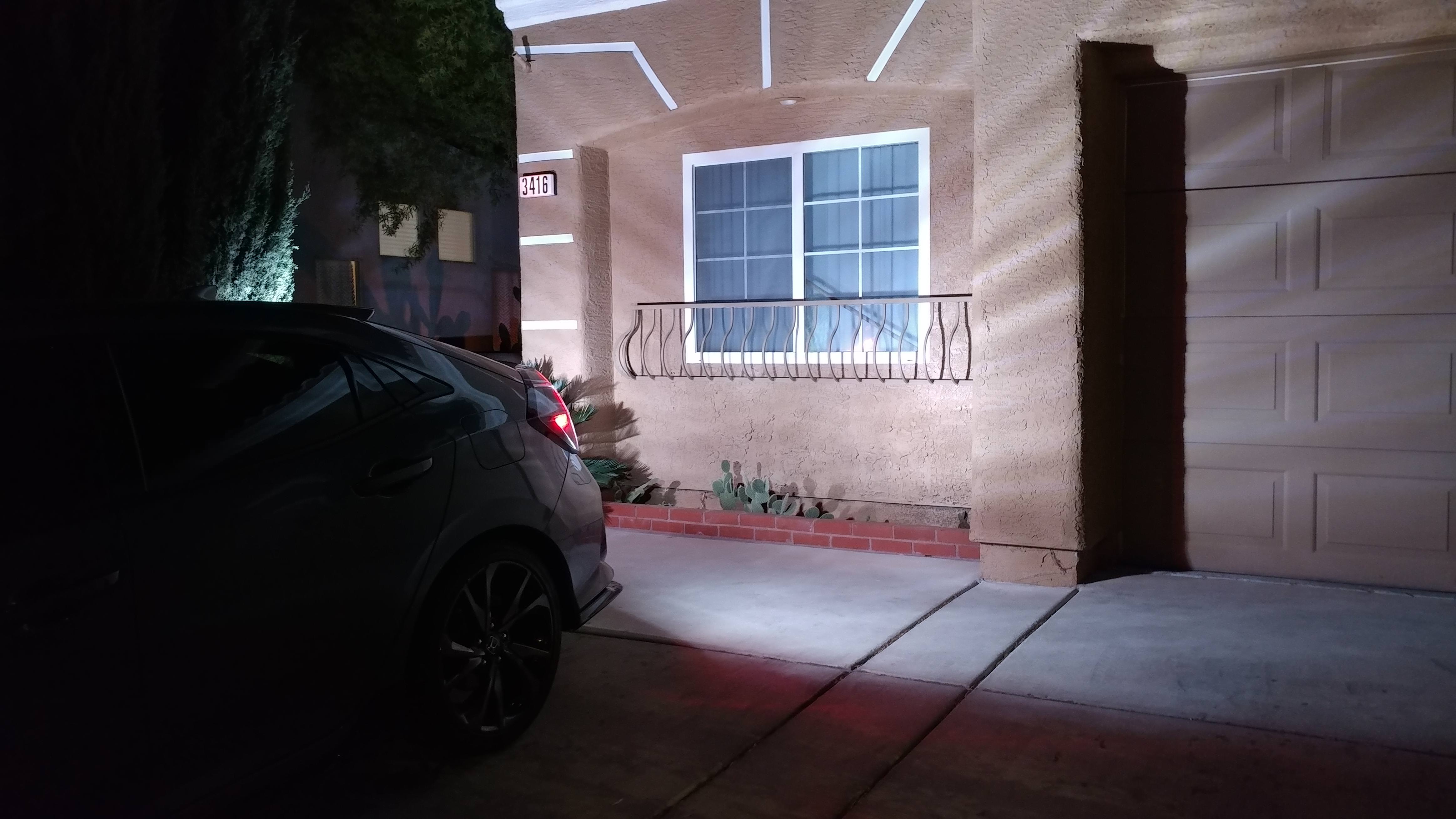

I'm rocking LED lights (specifically these ones) from theretrofitsource.com in my 2018 civic (same reverse bulb size as the 7thgen uses). here's how bright they are.
yeah, they're stupid bright.
