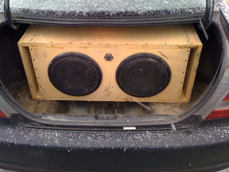

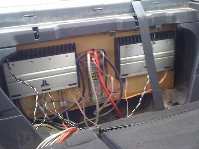

the box is unpainted, cuz that wont make it sound better
not so clean wiring job, not good but not the worst I've seen.

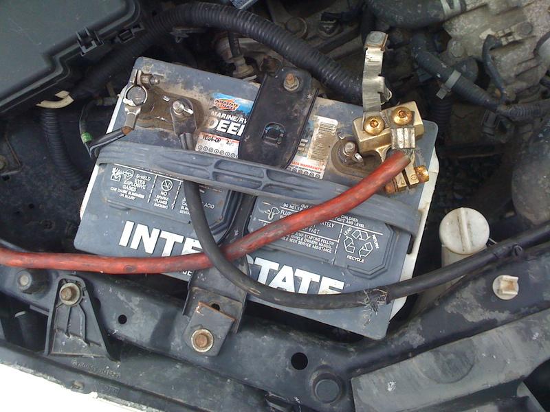

the battery if you look close to the bottom of the pic you'll see the piece of
metal I added to extend the clamp
