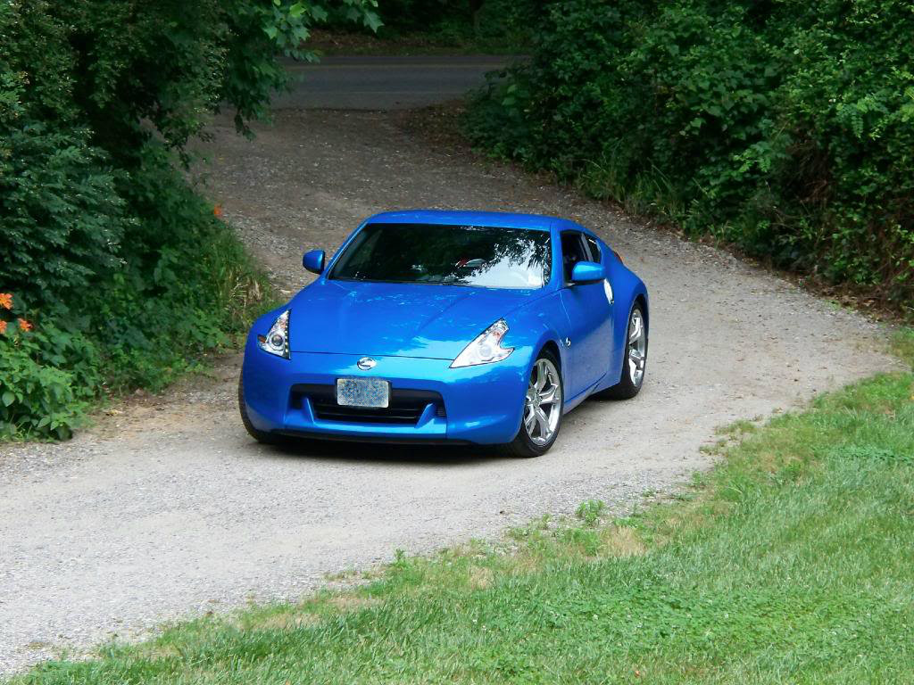

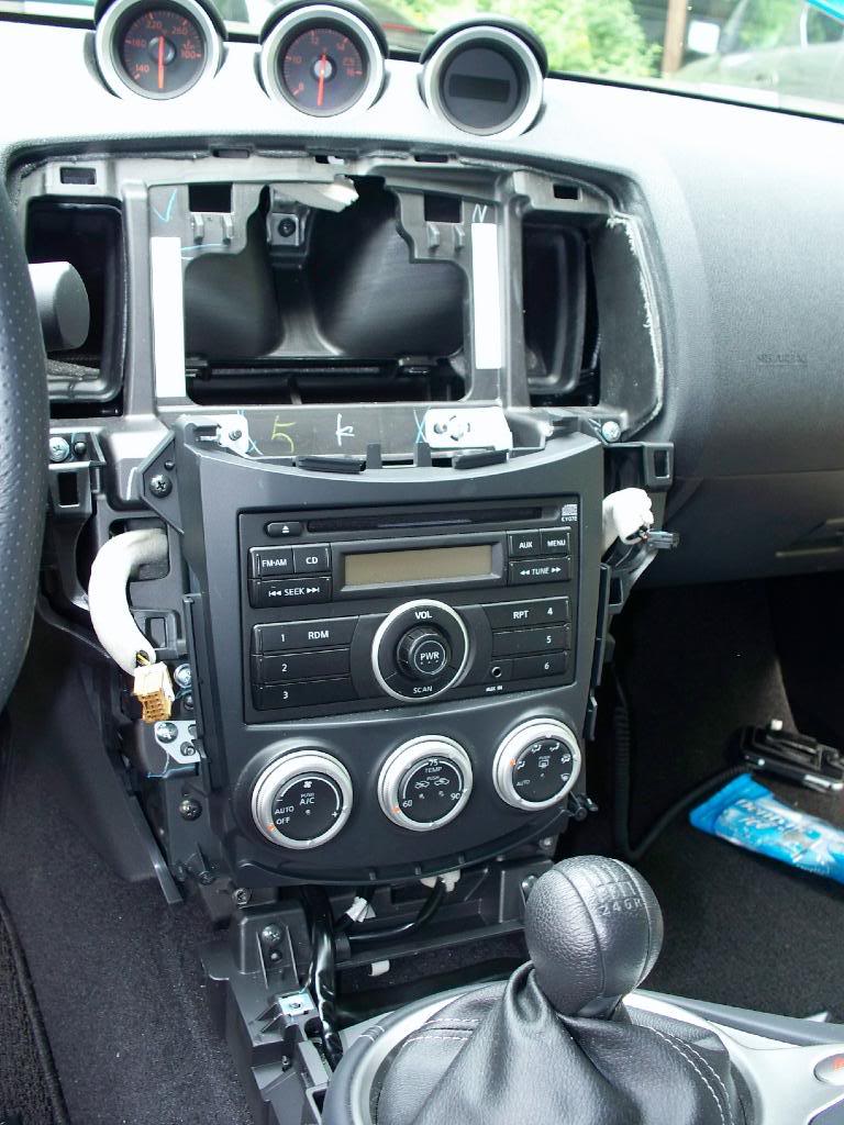

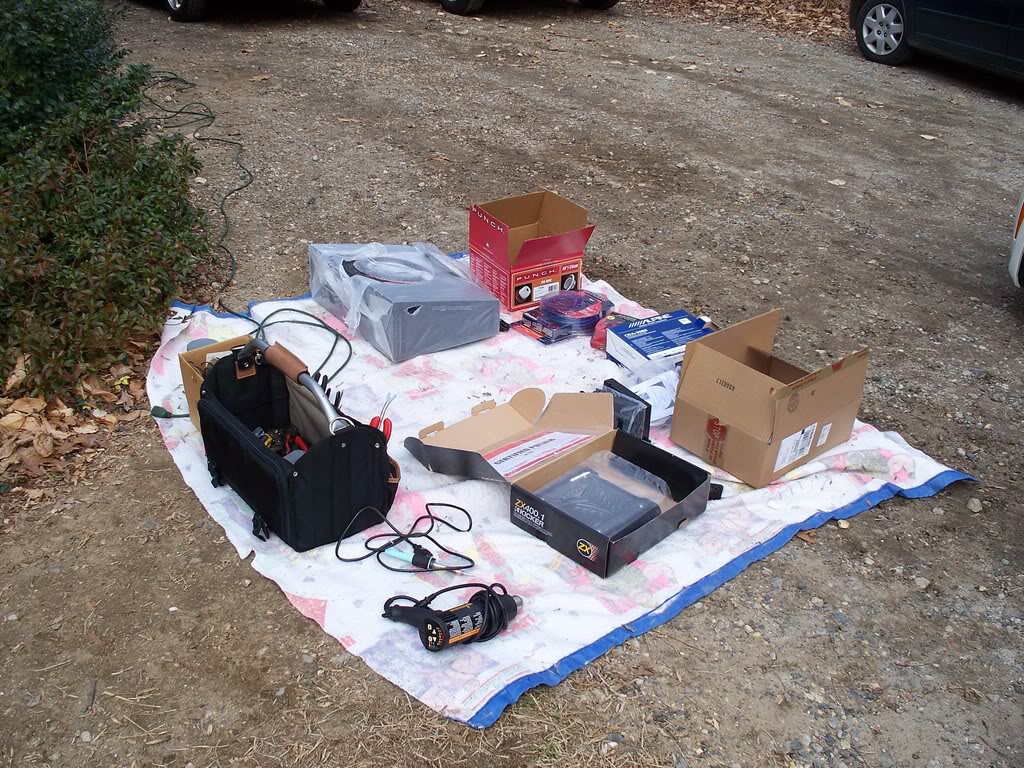

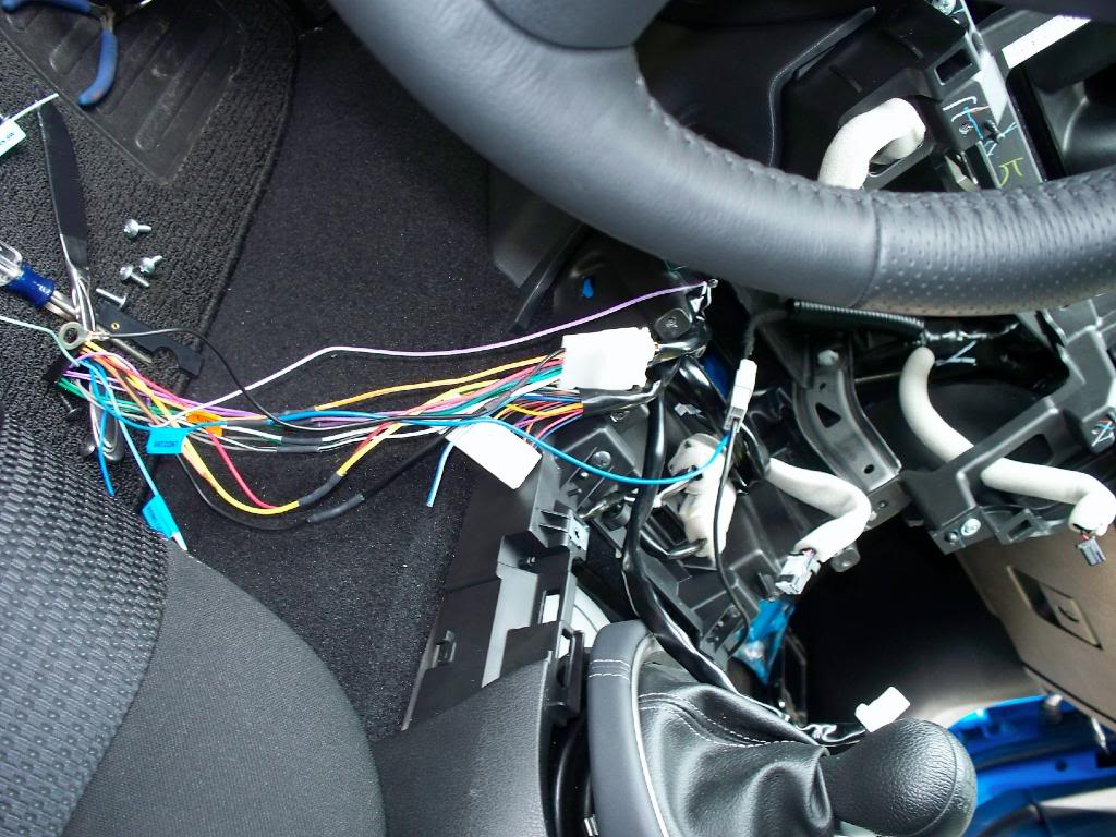

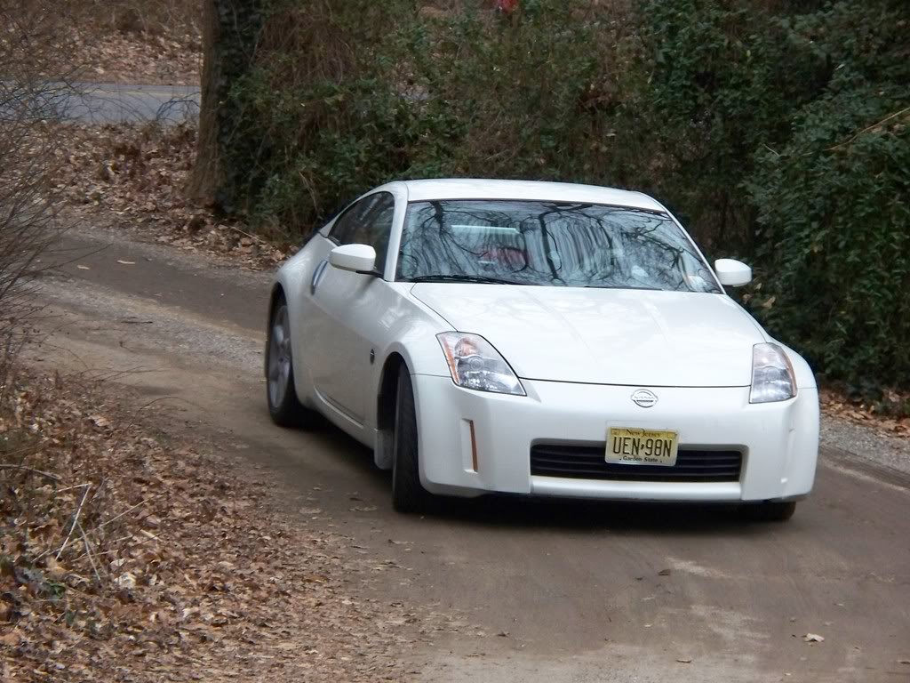

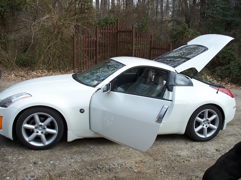

So last week I did an install on a 2009 Nisan 370Z take a look.
Here he comes

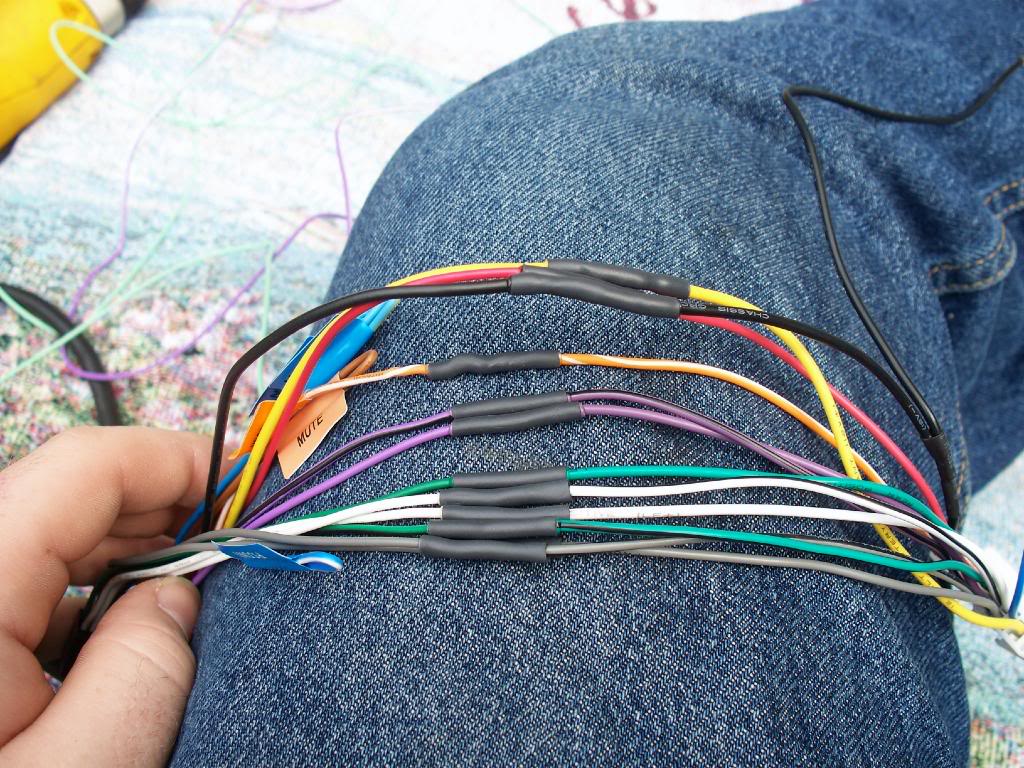

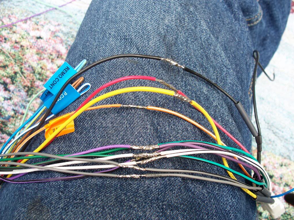

Start wiring Solder all up
Heat shrunk

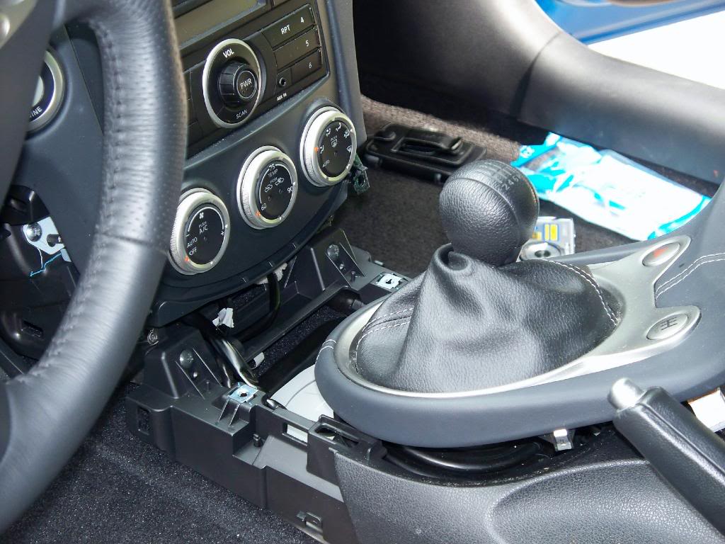

Dash taken apart

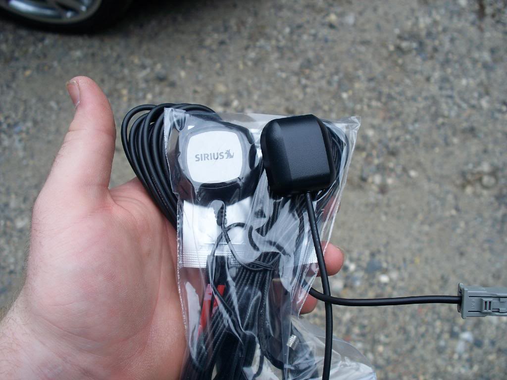

Antennas Sirius and GPS

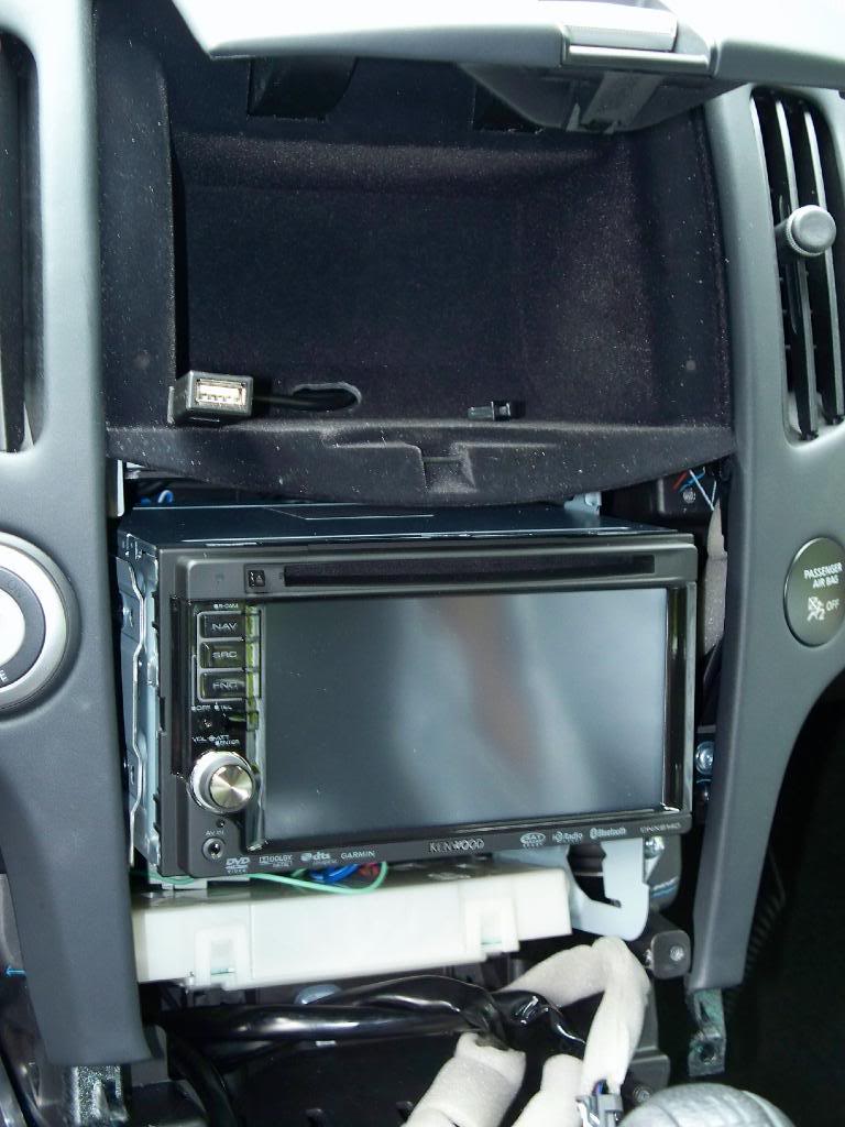

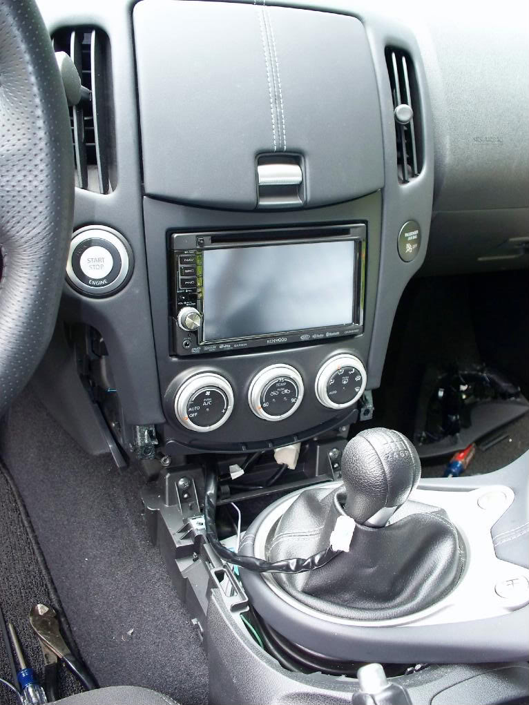

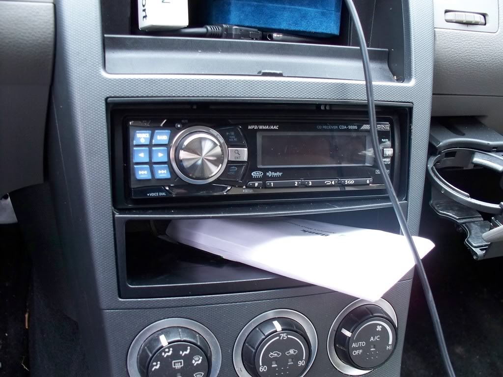

Head Unit installed
Let me know what you think

Nice job man

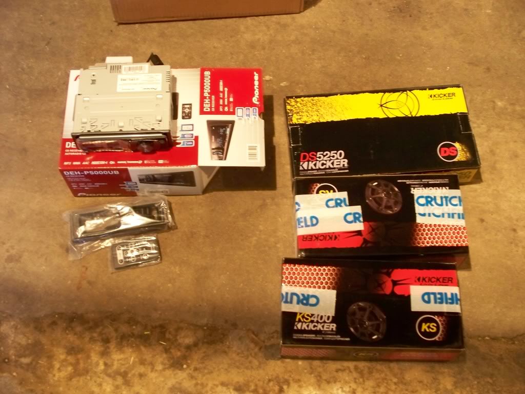

Here are a few older installs 97 Volvo 850. It was probably one of the more easier installs I have done. Here are some picks of the install.
The loot

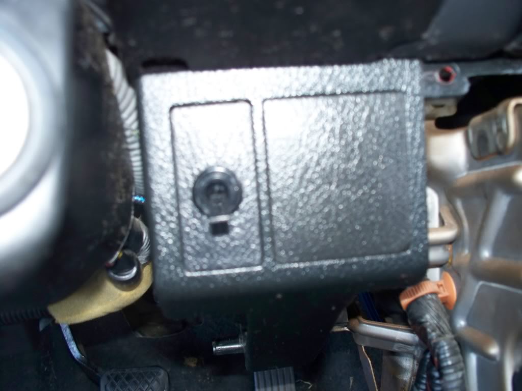

The hole for usb port
The usb port

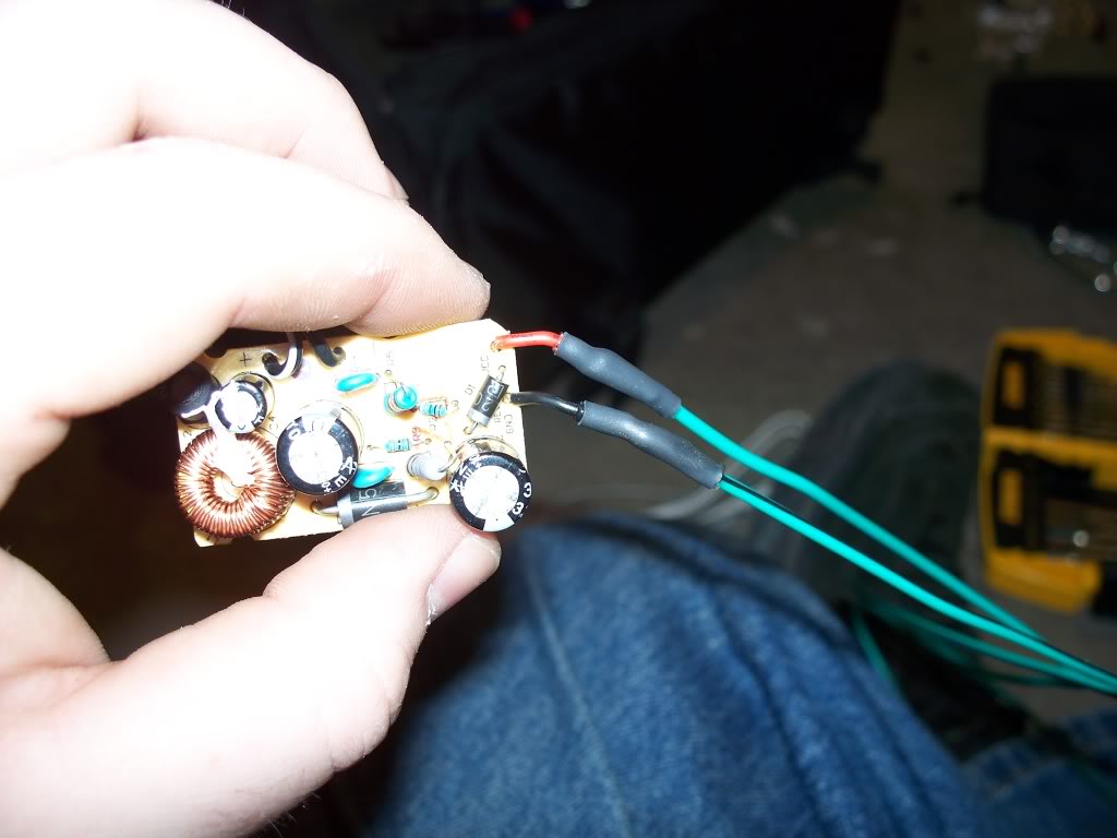

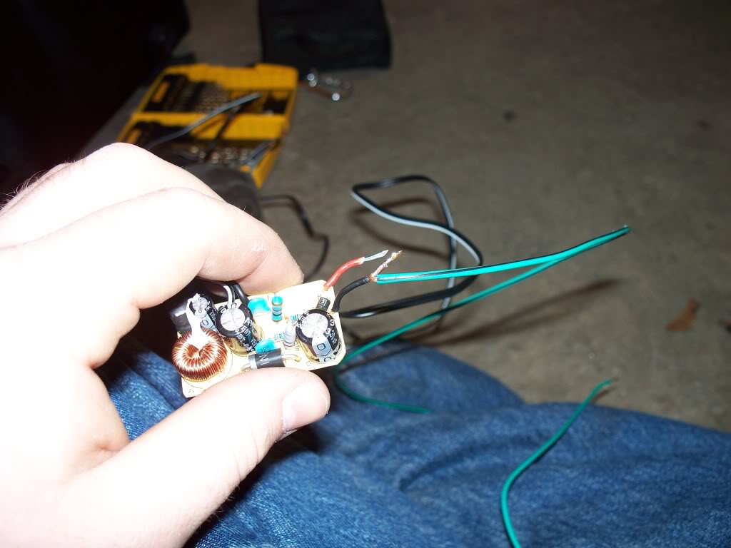

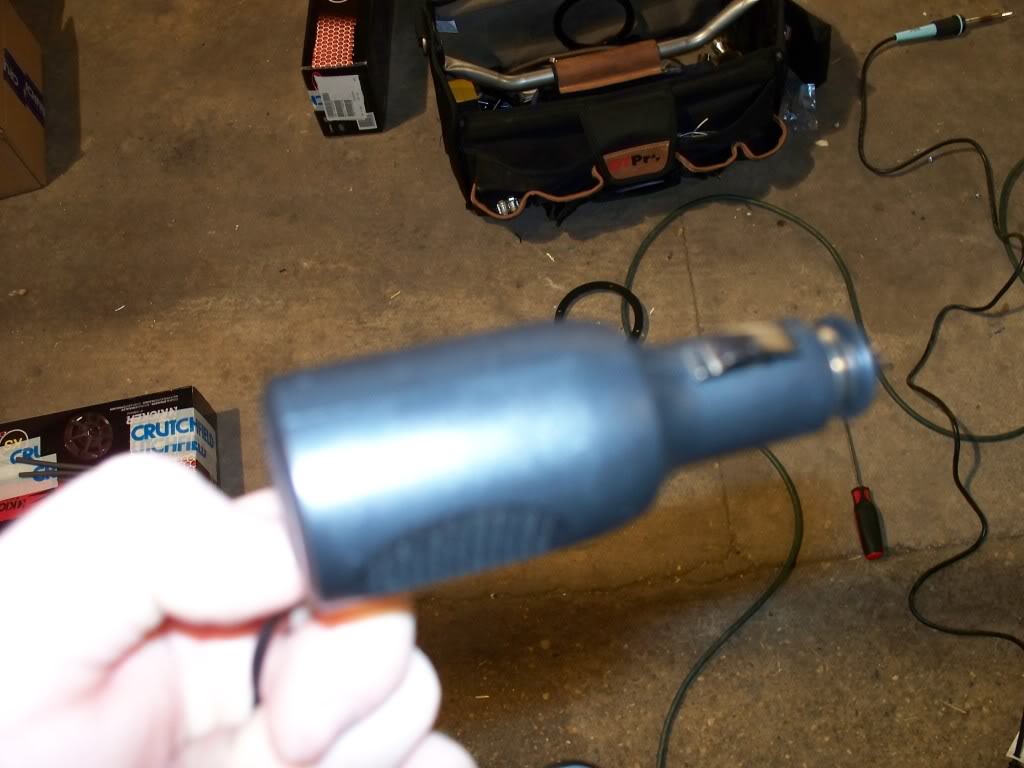

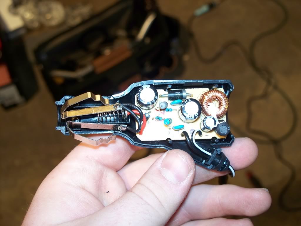

The sirius radio power plug lets mod it a little
Open it up
Solder it up
Heat shrink it all ready for being wired behind the dash after being wrapped in electrical tape.

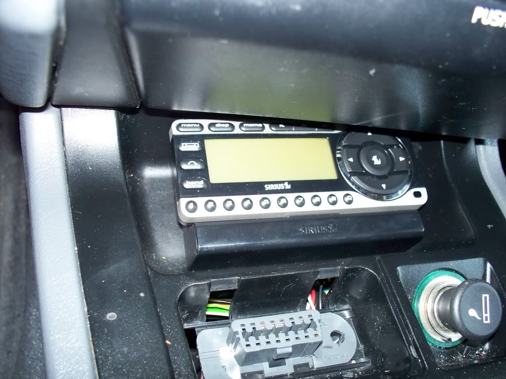

Location of sat radio needs some mounting

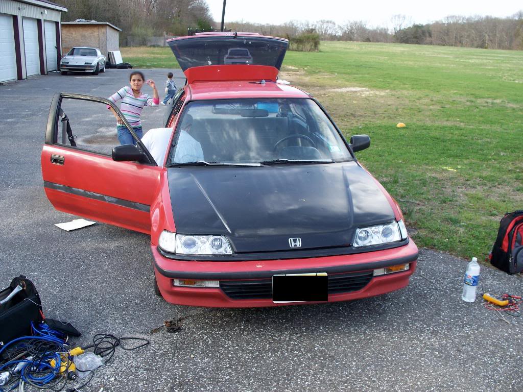

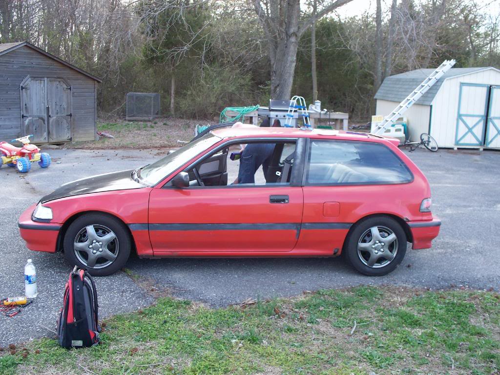

Here is one I did a while ago, it was a friends car.
Okay so today I started on my friends Honda civic i believe its a 91 but not sure. He installed the system himself and I will give him his props he did a good job. But now loaded with the right knowledge and my help we are going to overhaul the entire system. So enjoy the pics and the work to come.
The ride

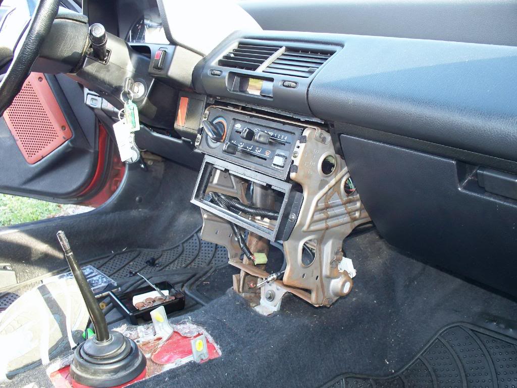

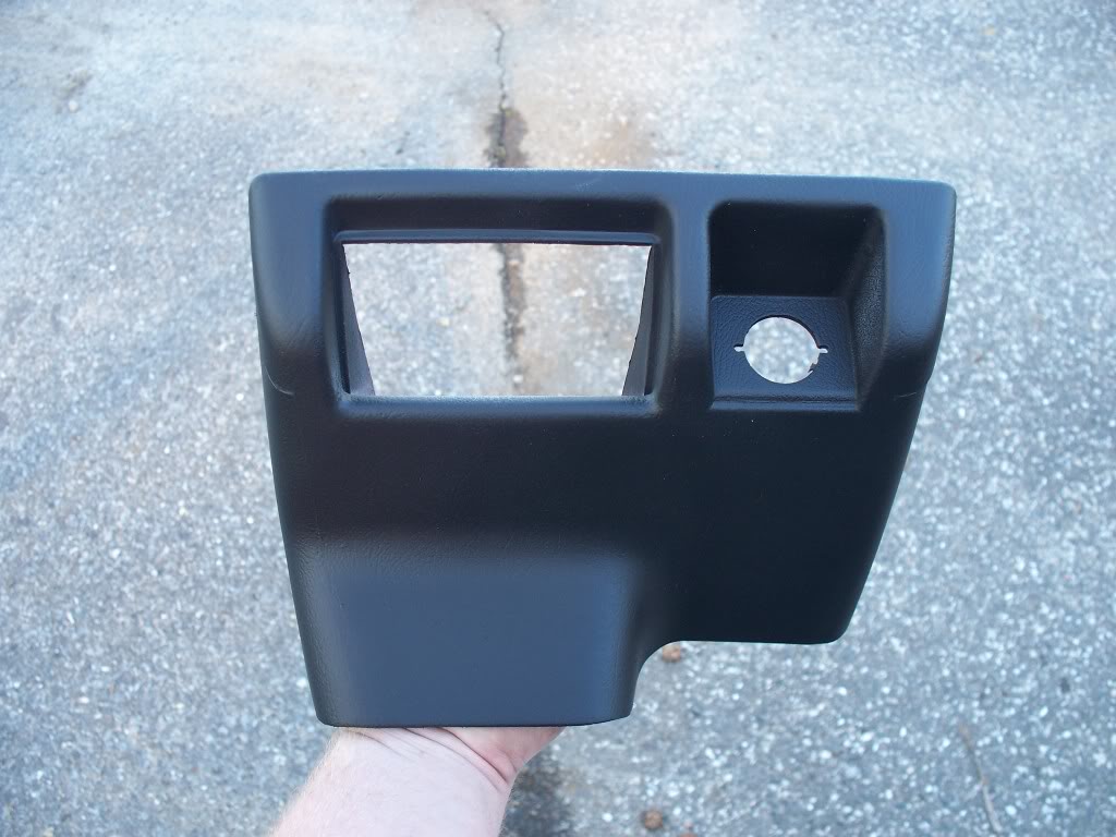

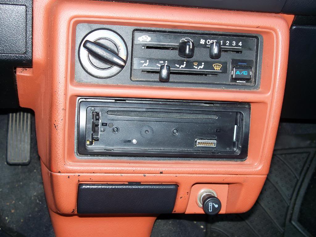

The center counsel

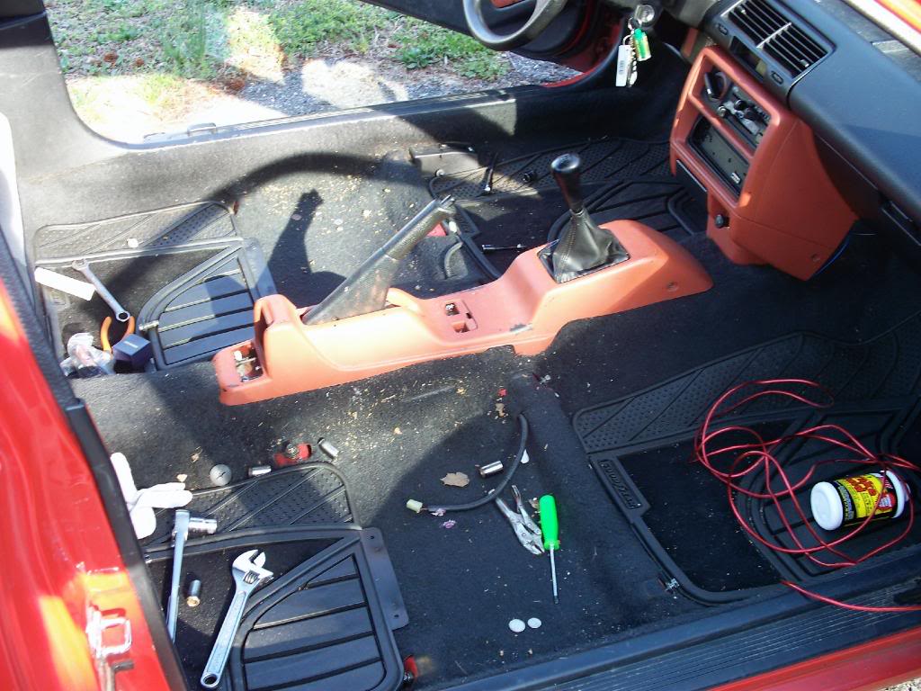

Torn out

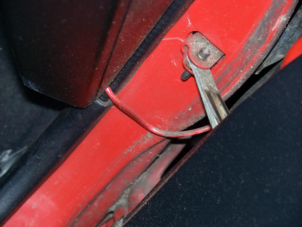

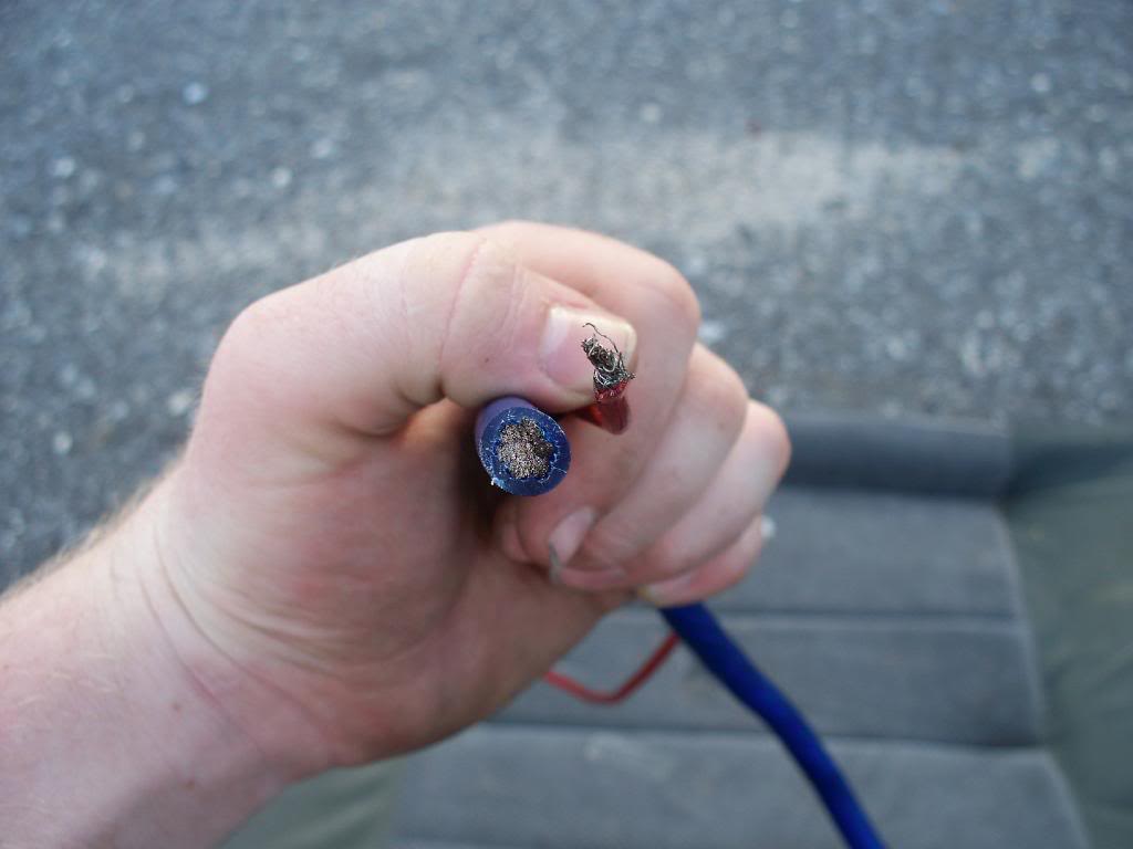

The small power wire sight and it was running a sony 1200 watt amp
Can we see the difference?:laugh:

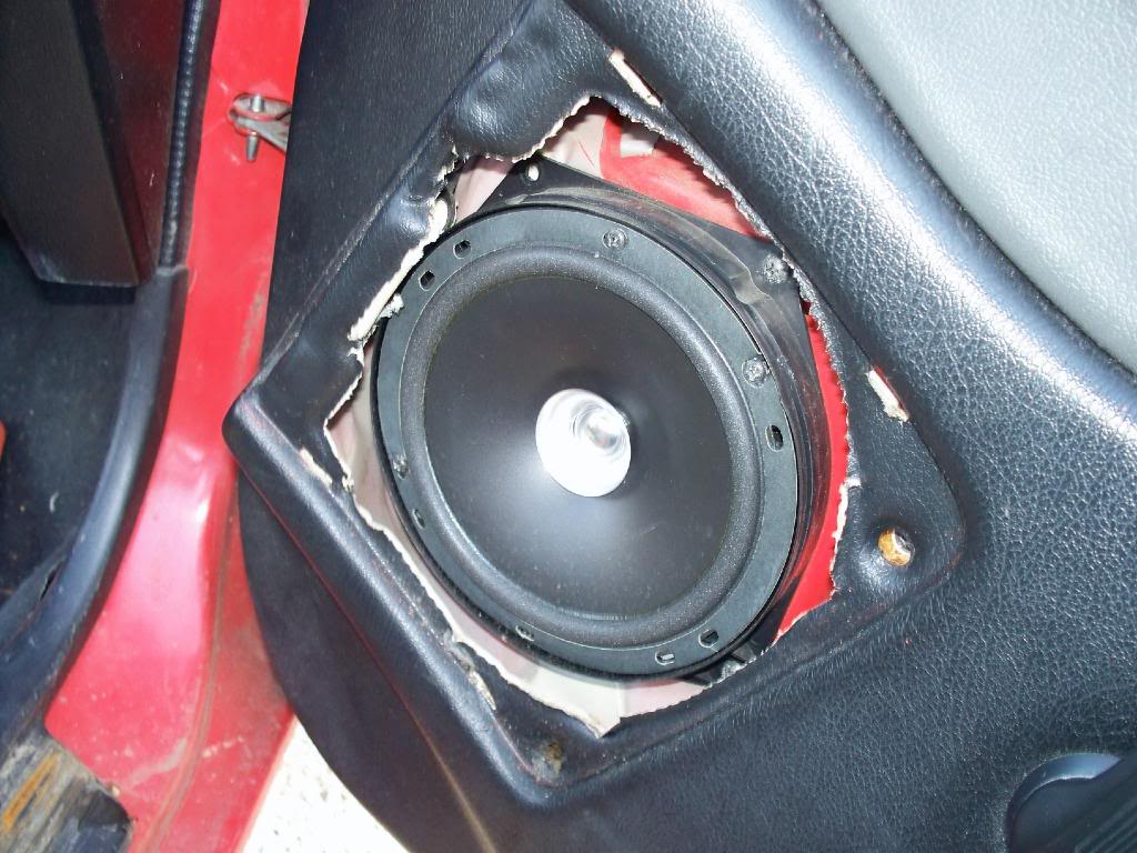

Dual speakers

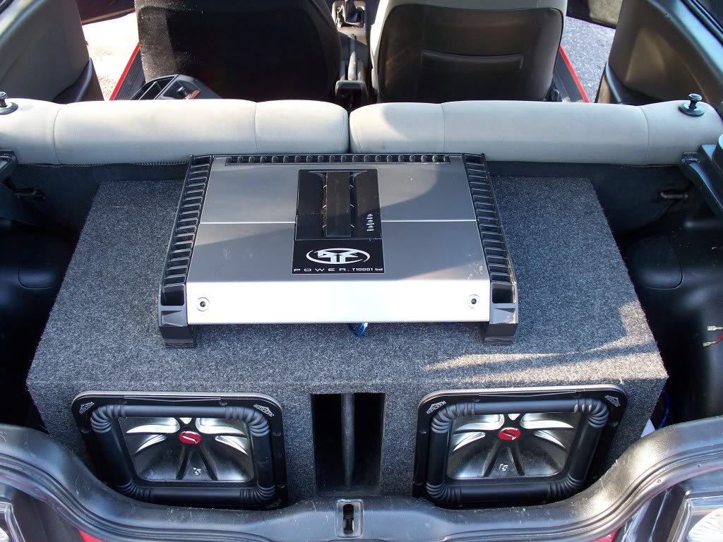

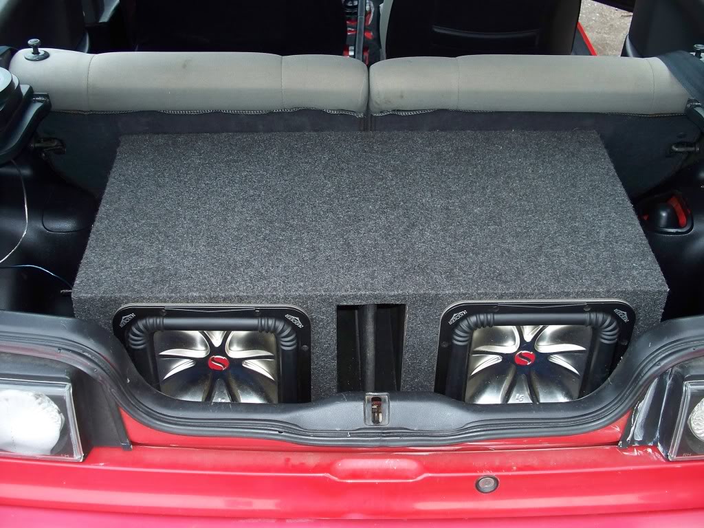

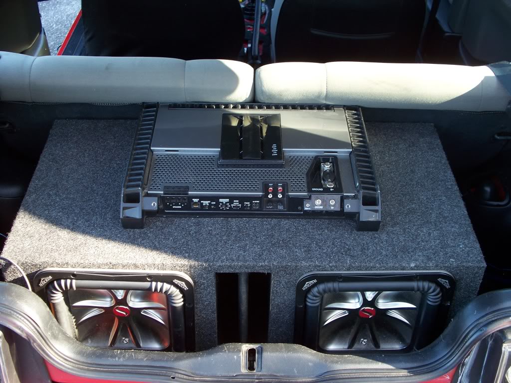

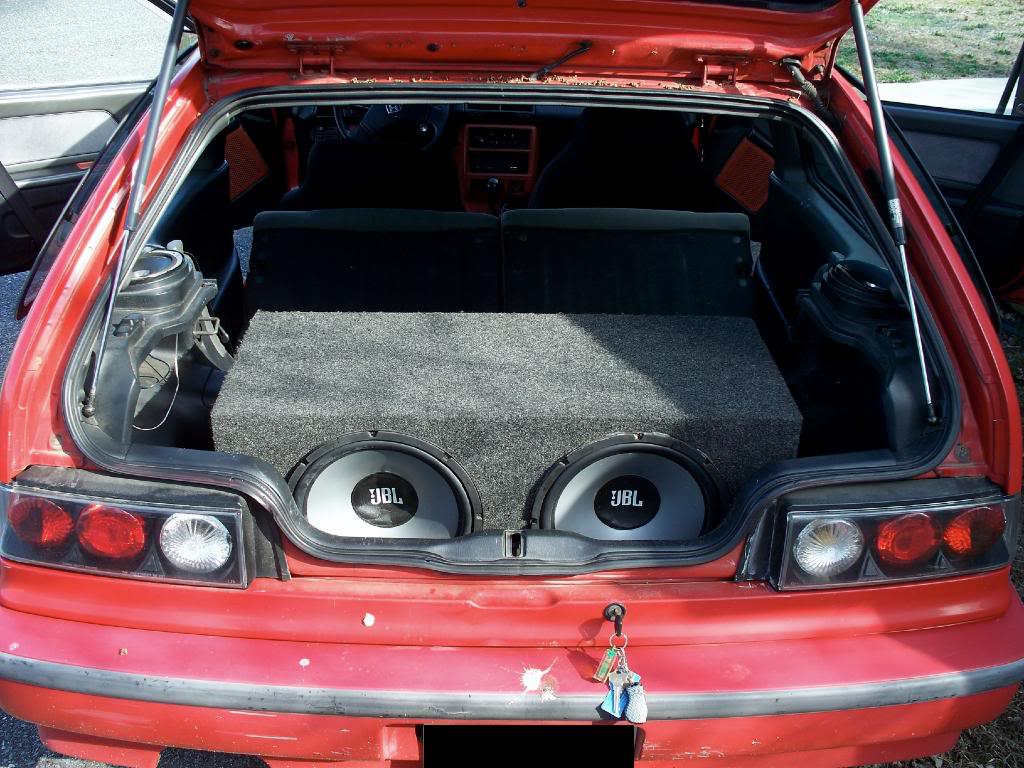

Old subs

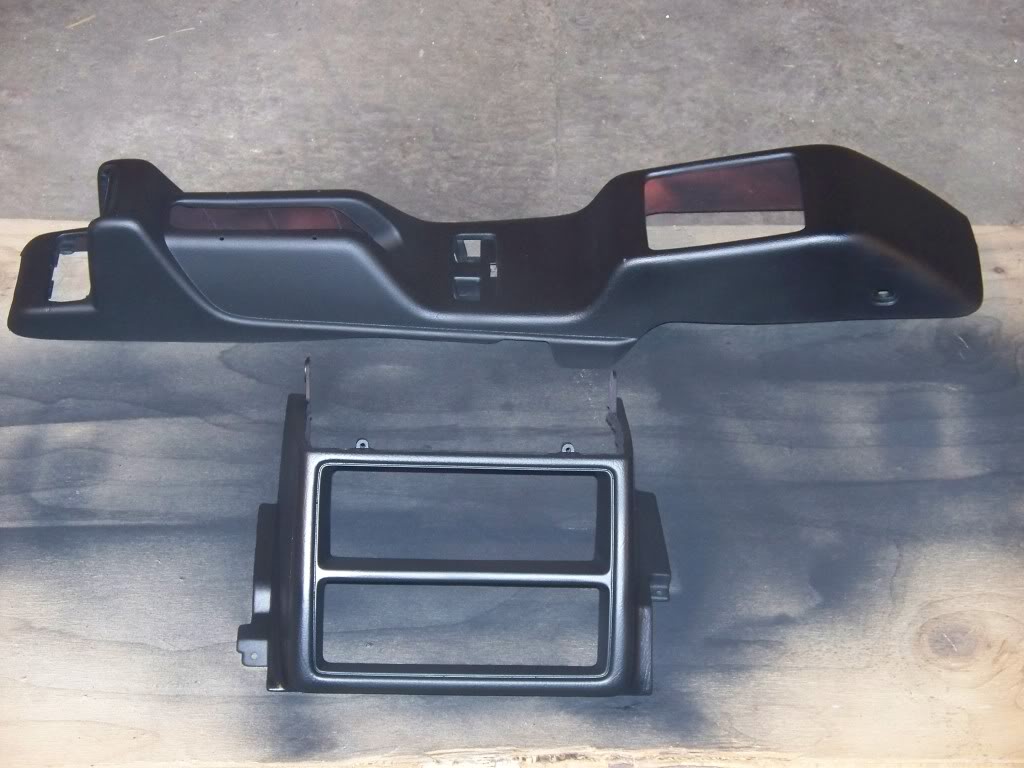

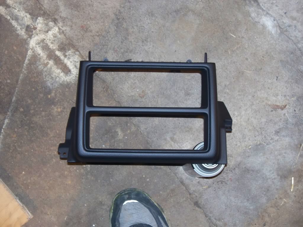

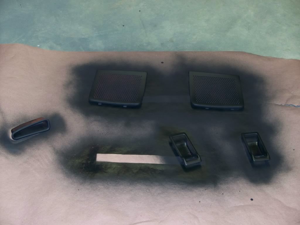

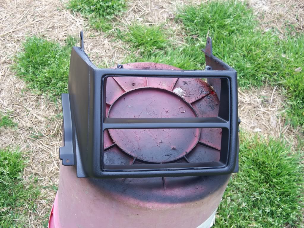

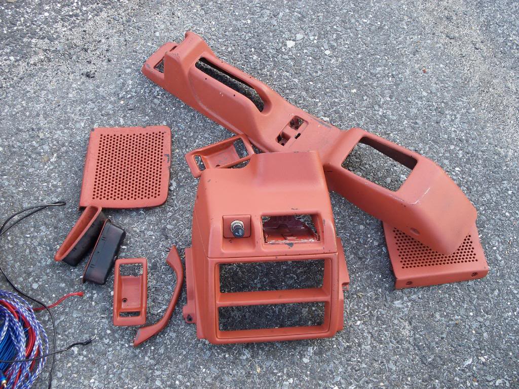

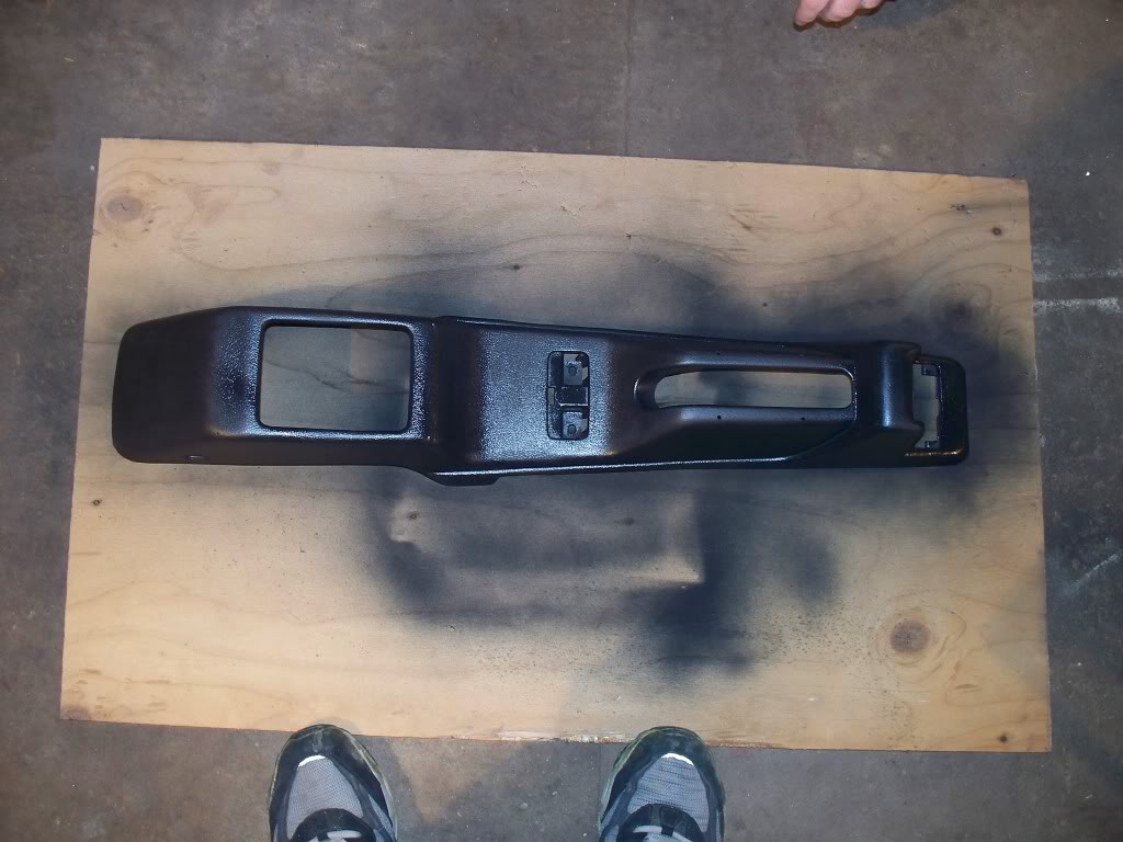

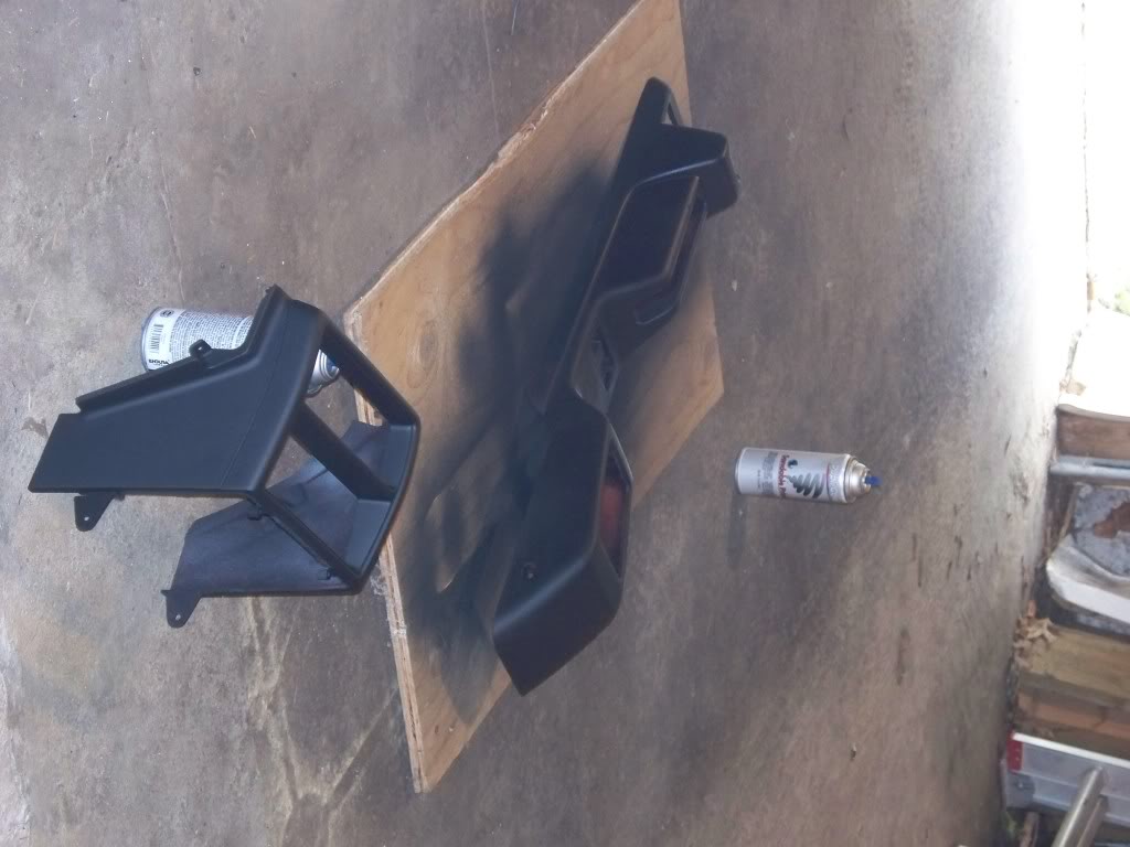

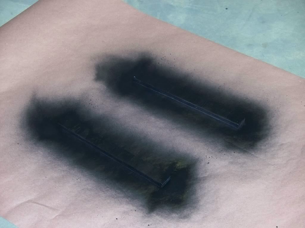

All the painted parts are going to be repainted black

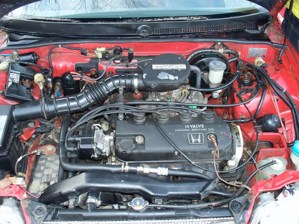

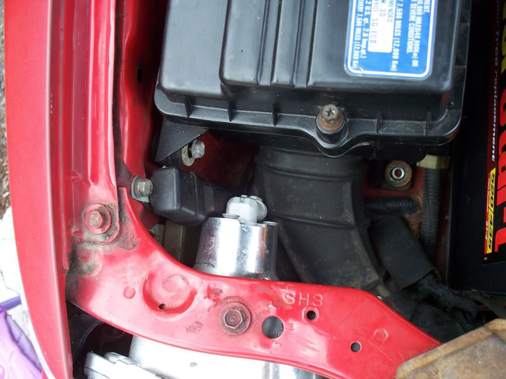

After I cleaned the engine

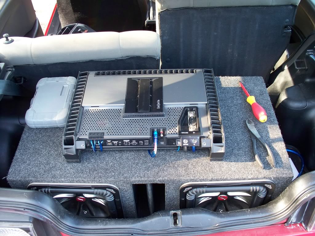

So all and all not bad he did a good job just didn't know what to get so tomorrow i will get picks of the stuff that's going in.

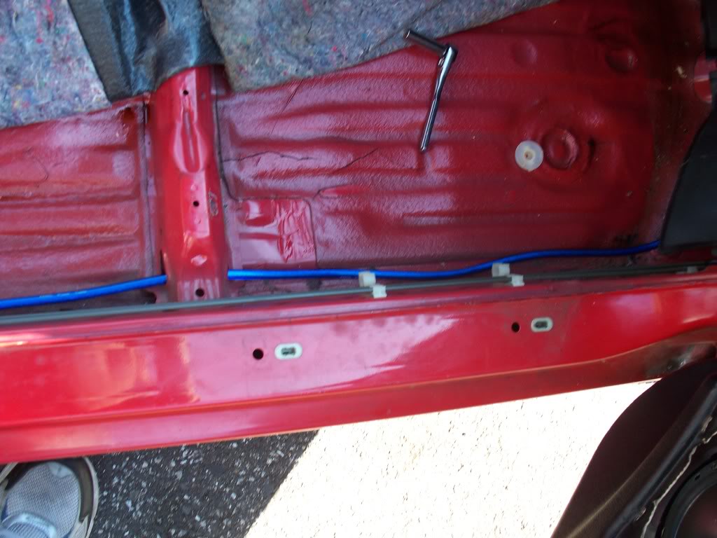

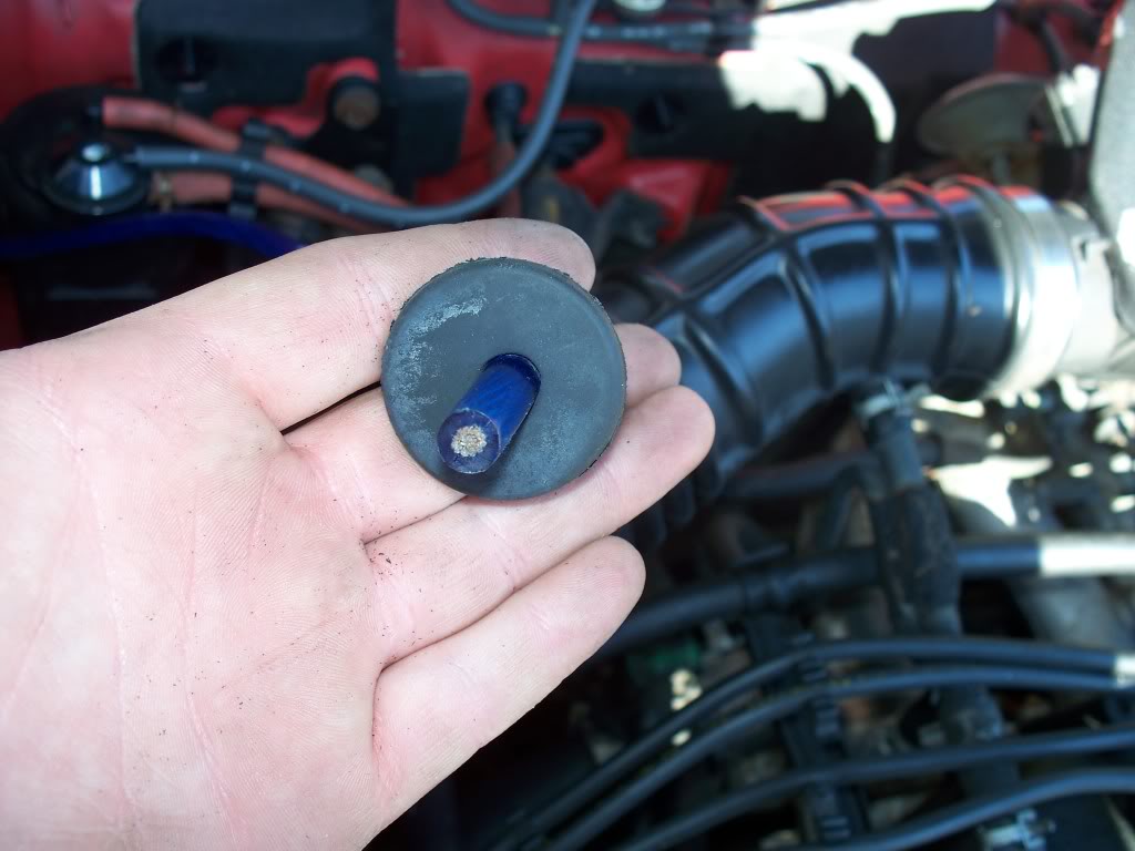

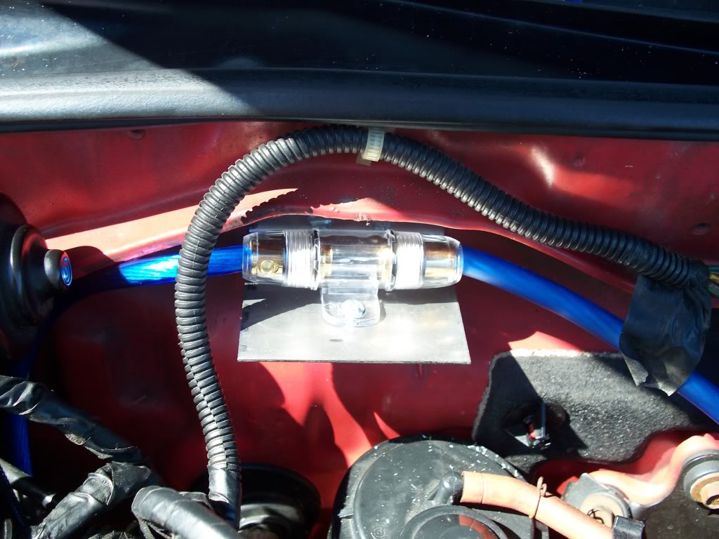

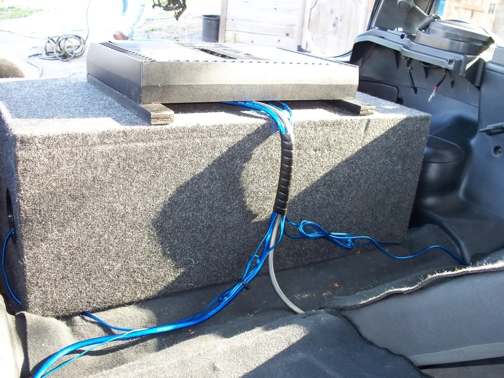

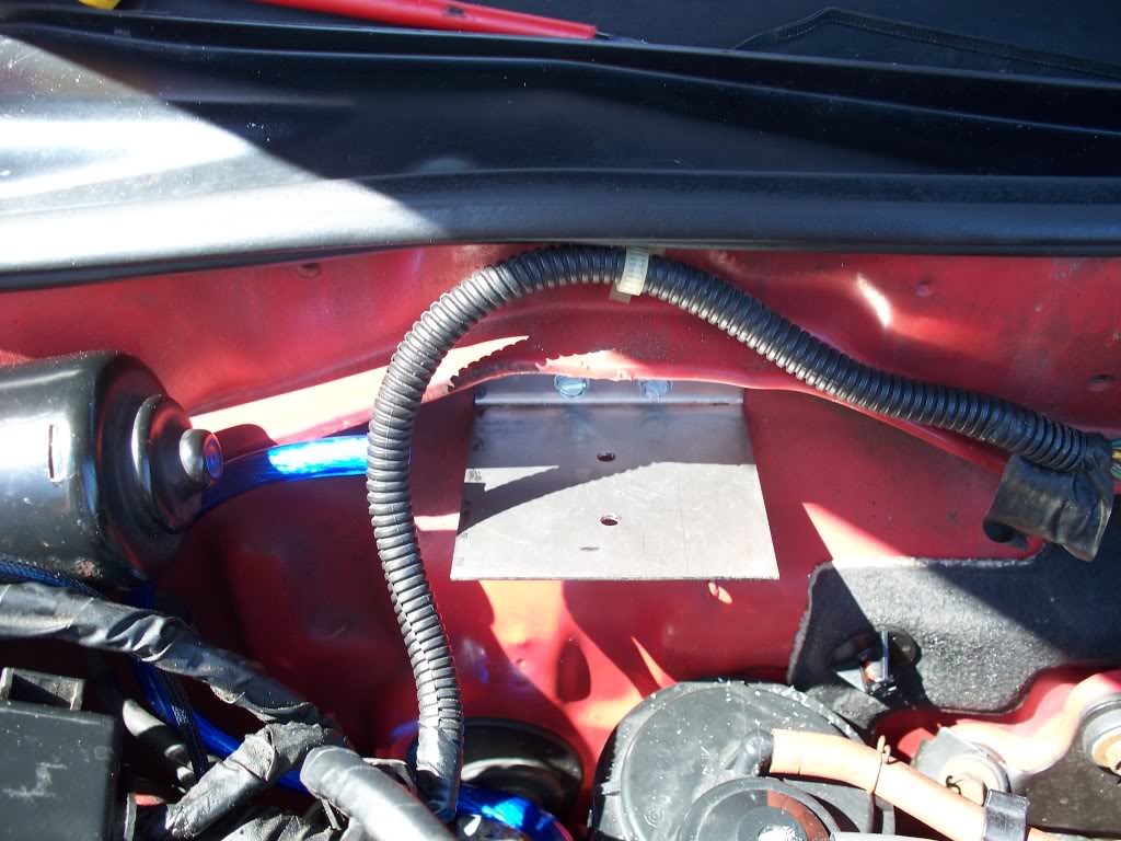

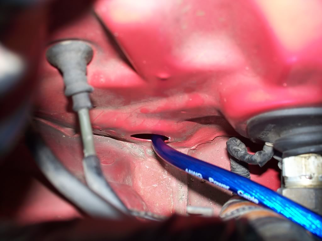

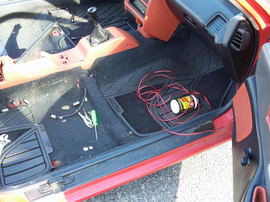

e got started today by running the wires. Here are some pics.

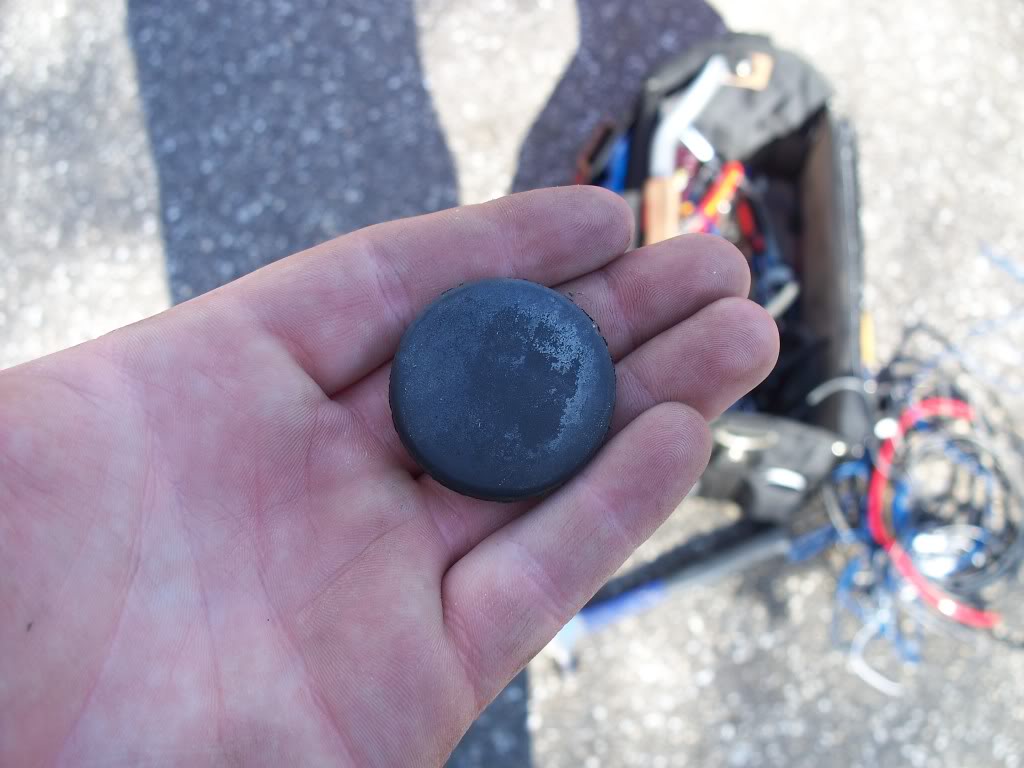

The factory grommet
Running of the 4 gauge

Running the 4 gauge threw the grommet

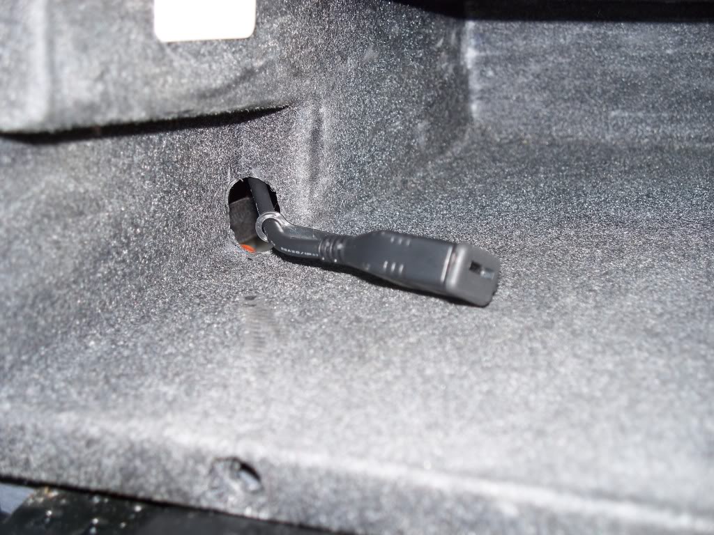

All ran threw the fire wall
Running the wire threw the wall always needs a helper. Just so happened he was there to learn and work. He like to get to work and learn.

Ran threw some holds in the floor braces.

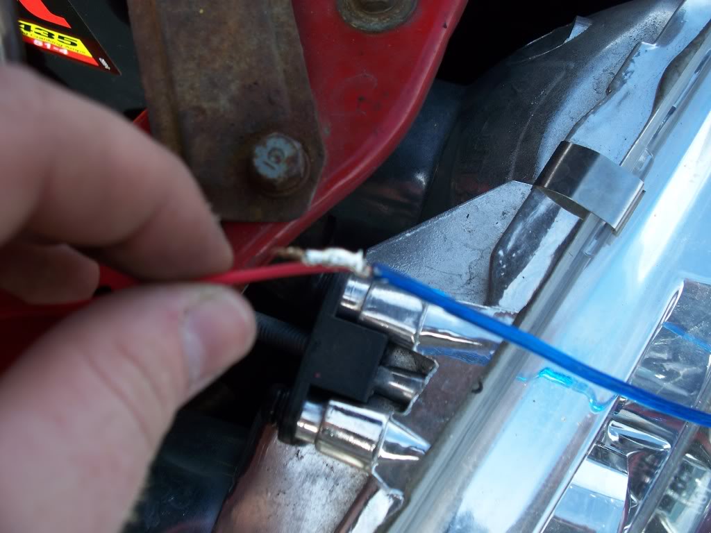

Soldered the + wire

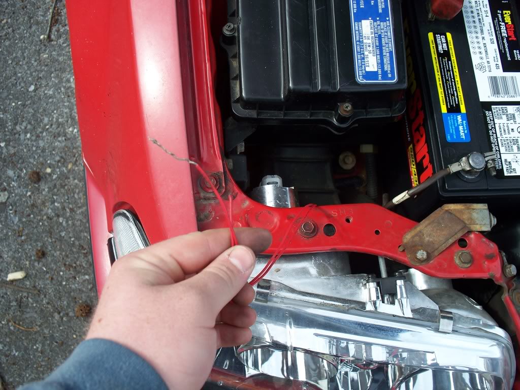

The wires all hidden the + wire is under the intake and the ground is under that rely bolt on the left. The wire was ran threw expandable tubing and the solider point was covered in head shrink

Put the Kicker L5'sin the trunk as well

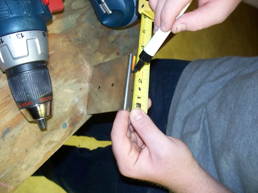

Okay yesterday we got back to working on the car. After the 2 days of rain. We fabricated the bracket for the fuse holder, and finished the angle eye power wire and the sub connections.
Measuring the hole locations for the bracket.

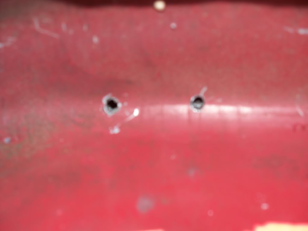

Brackets location made some pilot holes for easier install of the taping screws.

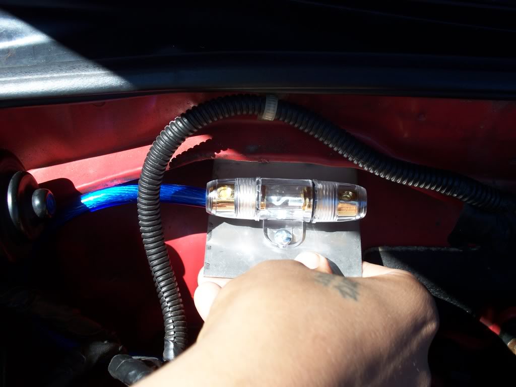

Bracket installed
Fuse holder installed going to cover the wire in black expandable mesh tubing

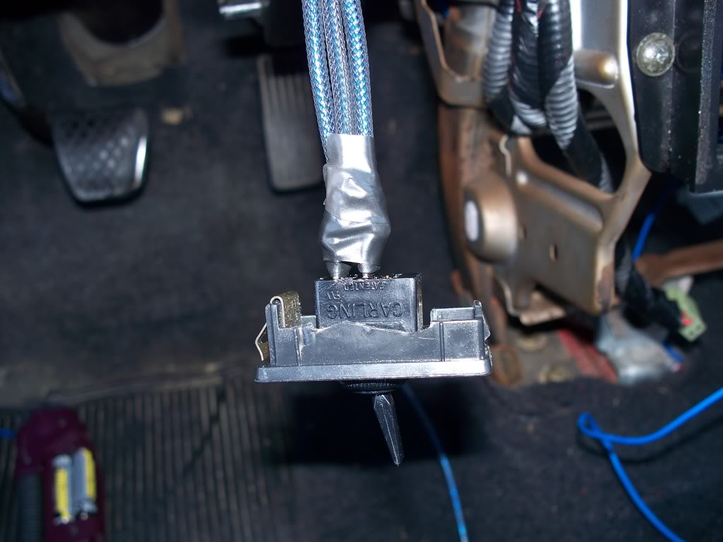

The wires for the angle eyes installed all soldered to the switch

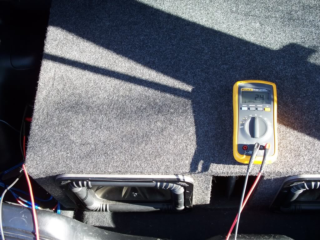

Both subs wired up to make out to 2 Ohms

One of the panels after sanded and repainted MUCH BETTER THAN RED

Haven't rely done much these past days. But here are some more panels that have been repainted.

Okay today we finished up the spray painting. Also made some gap brackets for the amp to sit up on so the wires can be ran underneath.
Here is Jerry cutting the wood for the gap brackets.
A look at how it will sit.
Painting them
How it looks painted it will set on top of the sub box.
The final pieces all done painting

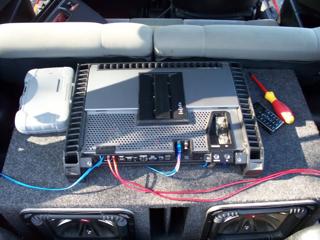

Yesterday finished the amp install and installed a temp head unit to test it out. Sounds rely loud to loud for me but for him it's good.
Quick wiring up to test it.
Wired it up with wires all tucked.
All finished with that
Wires all cleaned up will probably clean them up a bit more.
