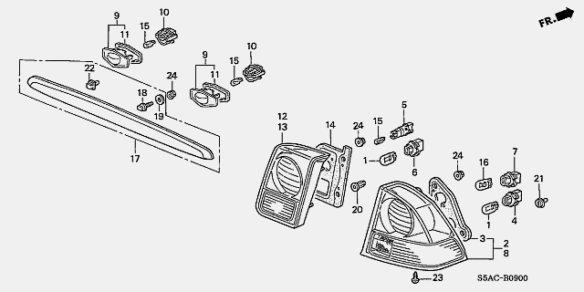

Hi there,
I have an 05 Civic DX 4dr. and have noticed last night that my license plate lights and parking lights( part# 15 on the diagram attached) at the back are not working when i turn on the switch BUT will turn ON when i open the trunk The rest of the lights are working fine. Any help will be greatly appreciated
cheers,
Dan

Broken wire in the harness in the trunk at the flexing point. RED/YELLOW wire.

You were right! it was a broken wire at flexing point. I guess Honda didn't put a long enough wire and the wires got seperated at the connector. I'm surprised HOnda only put an electrical tape at the connection. ANyways, I've placed a long enough wire so it wouldn't get stressed when opening/closing the trunk. Thanks for your help!
