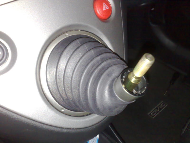

I managed to take the shift **** off ... but i am really struggling to get the shifter trim bezel off.
does anyone know how to remove that part?? i tried pulling it but didnt come off, i was scared to break anything.
i attached a pic of the progress i done so far.

any idea how to remove shifter trim bezel??
The panel surrounding the gear stick, as shown in the picture above.

Well everything I can find shows it just pops off, but that it is very tight. Either way, you have to use an offset tool to get the bolts off so it might not be your best bet.
Try this instead:
Remove the driver side underdash. The tabs should just turn 90 degrees and the panel should come out.
Open the glovebox, and remove the glovebox stops. Let the glovebox hang down.
This should give you enough access to remove the two bolts that hold the entire center dash bezel in. After removing the bolts, the radio/AC controls bezel will all come out as one piece.

Remove gear ****, squeeze boot and lift the lower panel along with it and it should free up a 6 o'clock. Coax the lower half of the panel off the shifter, the top panel including the radio follows pretty easily. Didn't have to use pry tools. Surprised me it was that easy.

from the pix of the bezel, it looks like it's just a snap on.. does this mean i can install my headunit b4 i get my bezel? i got my d3 before the weekend and i've been itching to put it in, but i've been having trouble getting a hold of the dash kit. (finally went to a more reliable retailer and it's coming in on wed)
