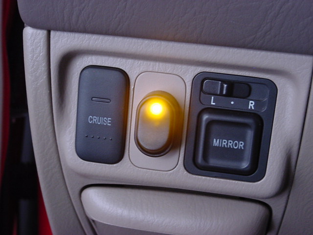

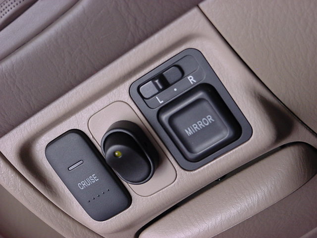

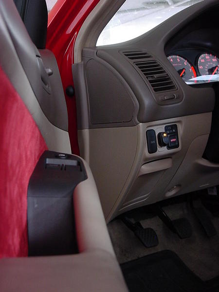

*shakes head* Man, there are already threads out there on how to wire these guys up, you guys are really making your life harder then it has to be.
I used the wire harness that it came with, used the connector thats below the passanger headlight (connector is brown), the other end runs through the firewall and is taped to the harness inside the cabin right below the sig lighter, look for it. From there, run power to your non ebay switch, and then to the corosponding spot in the fuse box with an inline fuse.
The downside to the autozone switch is that its manual, and if you have a dipshit attack, you can drain your battery... but the plus is thats its spimple to wire, its easy to mount, and blends very well... I had a friend searching on my dash for about 2 minute when I told him to flip the figlight switch on the left hand side... shoot. I'll go and take a picture of it.
