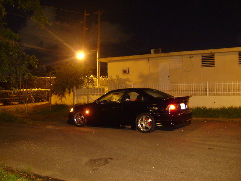

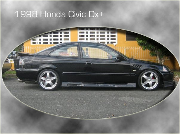

Hello guys!
Well I too have a 98 civic DX but the only thing left to make it ex is the sun roof. Meaning that I got to complete the installation about 5 years ago. I went to ebay and bought all the necessary accesories for the conversion: Motor, actuator (regulator) buttons, SI pannel but you guys are right DX does not have the necessary harnes to complete this. I took the power from the battery and split it for the driver and passenger. I played arround with the wire (I don't expect you to do it) while it was appart and found the In possitive and In negative that brings the power to the buttons, and then found the other out possitive and out negative that went to the motor. They are opertational but I would like to have the door piece wire harness to properly install it.
I did come to and issue 4 years after, the window was becoming off track. May be due to the lack of knowledge on the matter from the mechanic (ME).
By the way, If you say why did'nt you just buy an EX??? Well... cuz is not as fun. That's what Tunning is all about.
