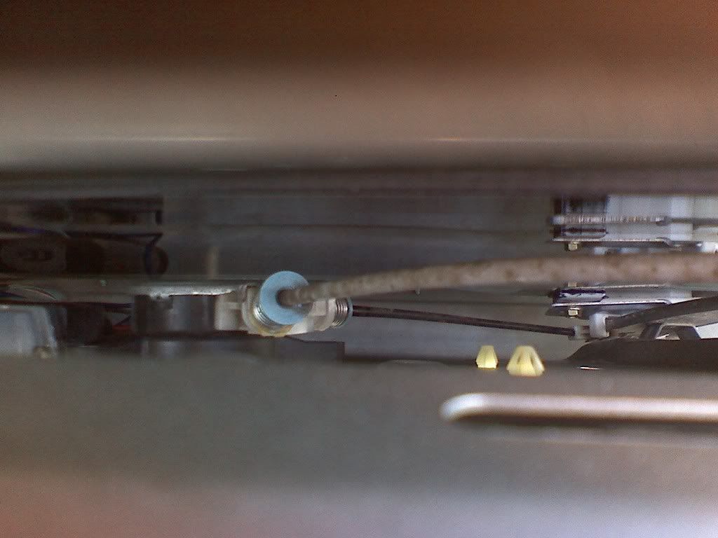

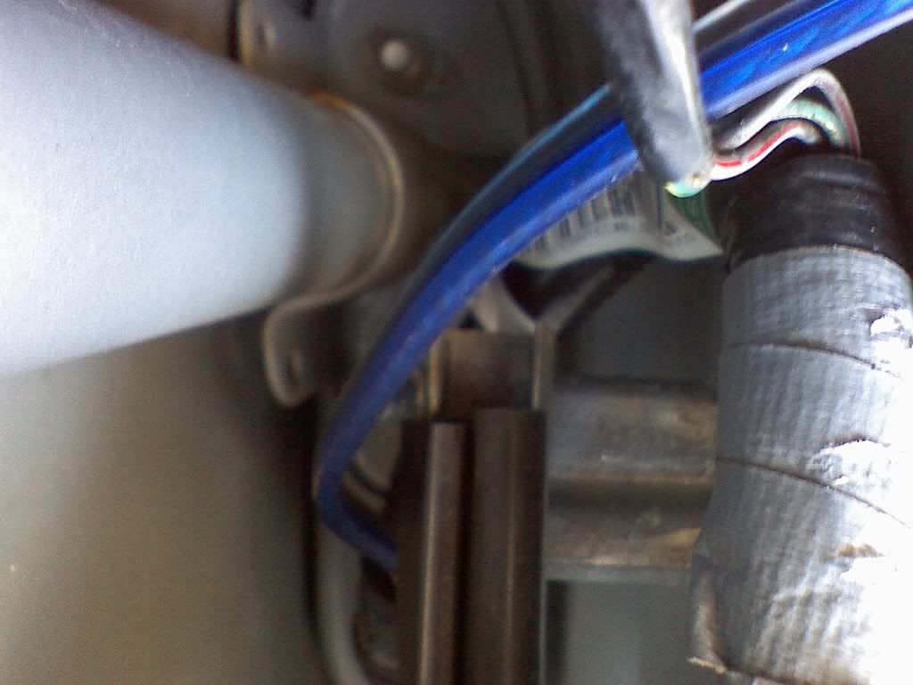

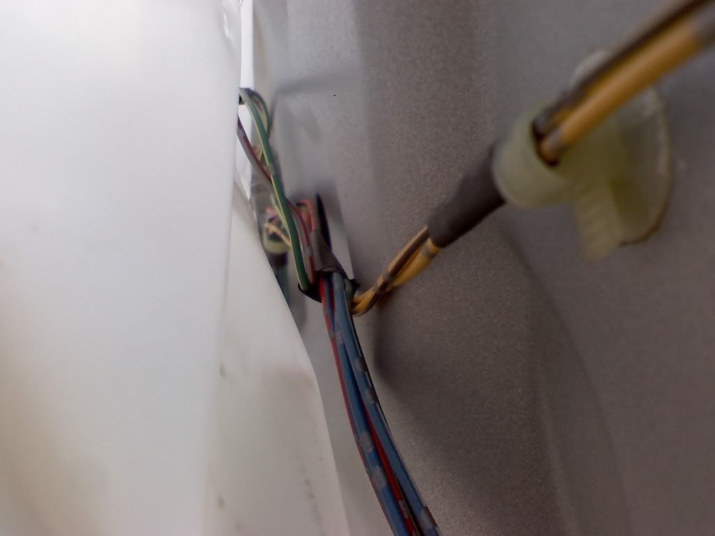

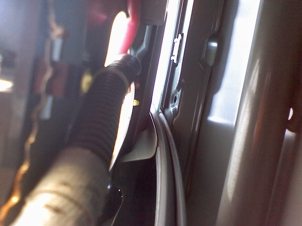

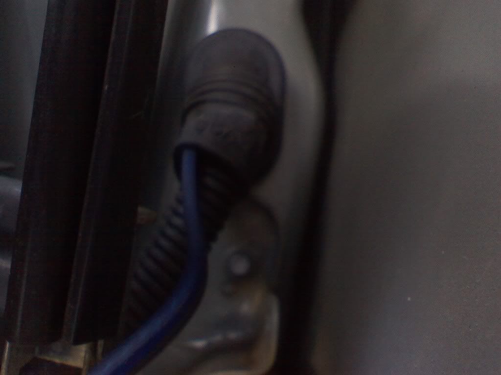

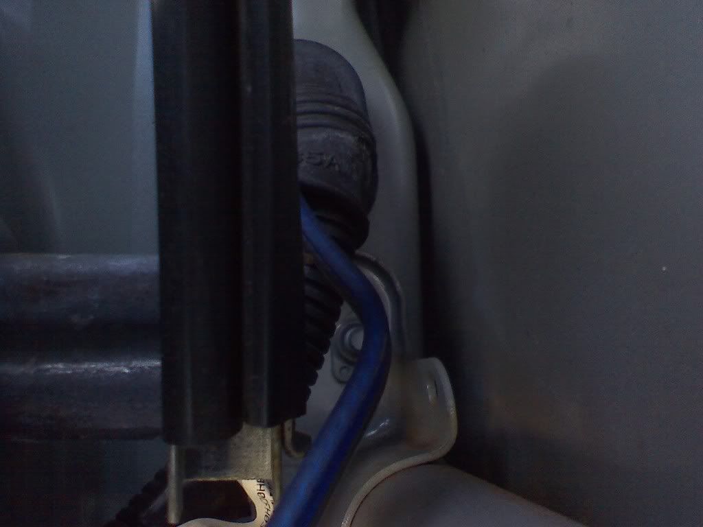

Re: Is a power window conversion possible?
Sorry it took so long. Questions just post, the blue/gray wire is speaker wire.
All Camera-phone Pics! all from looking down into the window bay, up and around the speaker hole, and under the plastic covering that covers the door!
You the man!
OK so I see where the red/white and green/white wires go into the door through the tubing but I see in the last picture there's also some blue wires and some yellow wires. Do you have pictures of where these come into the door? And also, do you have pictures of the wires that lead to where the power windows plug into the unit in the door?
all of the wires come in through that tubing. and the plug that plugs into the power windows actually sticks out of that plastic cover. its ends with a little harness that resembles the speaker harness in the door. and i have no clue what the yellow or blue wires are besdies maybe power locks
