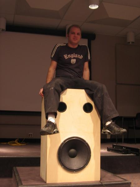

Well, how low do you want to go? The most recent box I built was a 15" home sub with 8 cubic feet of airspace, dual 4" diameter ports of 11" depth and it is tuned to about 35 Hz. That tuning was measured in an anechoic chamber and the expected was about 36 Hz from our software. I couldn't be more pleased with how low it plays. Remember, every additional inch of port space takes air space away from the sub. 31 is very low but not much lower than 36 Hz.
