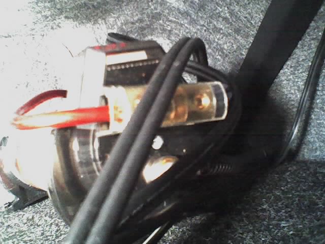

here's my cap - not the best pic but I'll explain it as best I can. I'd recommend at least one distribution block to consolidate your grounds, a second block if you are running more than one amp to consolidate power leads. The capacitor wires inline between your battery and amplifier(s).
The red wire goes to battery, the power lead coming off of it connects to a distro block connecting power leads from my two amps. The black lead directly below connects to a distro block consolidating my ground leads.
Hope this helps.
