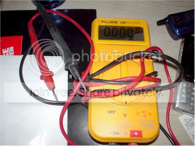

and heres my volt meter i found in my basement. do i just stick the negative and positive to the screw in terminals on the amp where the speaker wire (NOT RCA WIRES) connects to the subwfooer?
I need lots of help. lol thanks!

I used the Sounddomain method to set my gain on my amp:
1. Turn volume up to 75% max (LOUD) (about 45 on my headunit)
2. Play THe 50hz test tone.
3. Get the voltage im looking for using this forumula. Squareroot(RMS power * OHMS)
3a. WIth that formula i get SqaureRoot(400 * 4) = SquareRoot(1600) = 40 Volts
4. I slowly turn the gain up till it reads 40 volts from the speaker outputs on my amp.
5. I find that at 45 headunit volume i have to turn up the gain to about 65 %, just a little more than halfway to get the speaker out to show 40 volts.
