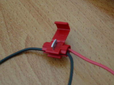

A really easy alternative would be to use "Tap-In Squeeze Connectors" When you push the metal piece down with pliers, it strips the wire for you. It's also clean, simple, and really sturdy so there's no chance of the wires disconnecting.

those things are commonly called "tap splices" that can be found and any hardwhere store for a few bucks for like a 30 pack

^^ Those are the tap connectors as mentioned.

those scotch taps are junk if you're tapping higher voltage wires or larger wires.
