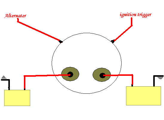

use an rv solenoid (not an isolator) to seperate the 2 batteries
rv solenoids are very efficient whereas isolators are not

Very true, You can trigger the solinoid from your ignition, so when the car is on both batterys get charged. When the car off is the batterys are seperated. I have two batterys for my system although Im am not running the solinoid, its the proper way.

but seriously you can use a dare I say a FORD! mustang or escort starter solinoid there 25.00 USD at any parts place!
