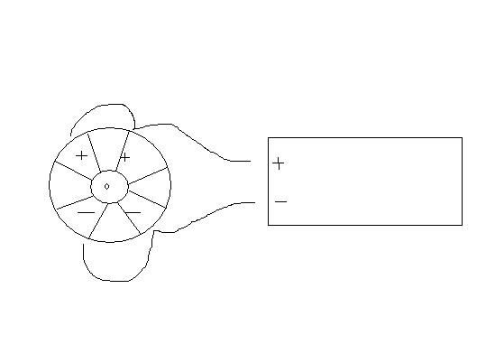

if you went with one sub (the dual voice coil) then connect both pos to the pos of amp and then both neg's to the neg of the amp.
They are 2ohm voice coils so by wireing them in parralell it will give your amp 1ohm of resistance. Which is the lowest your amp can run at.

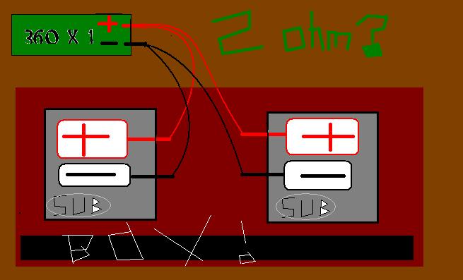

no the setup i got now is ONE 2 channel amp (150 watts at 4 ohm X 2 ( 2 ohm stable for 2 channels) and 360 watts at 4 ohm X 1, and 2 subs 4 ohm SVC

not going to get all the power out of the amp, you need dual voicecoil subs that are 4ohm coils each. or you need an amp that is capable of 2ohm mono loads.

heres how its hooked up now,
rember the amp is 2 channel, bridged
multimeter said 2.1 ohms
i set the gain to 26.9V

Yes that is parelleled at 2ohms. But is your amp stable at that?

i dunno... lol the fuses havent blown... i got a power accustik 620/2

According to power Acoustik, the amp is not stable the way you have it. Like EX said, you simply cannot do what you want to do with that equipment. You might be getting away with it, but it will eventually be the death of that amp. I vote sooner rahter than later.

no its not, its a 4ohm mono amp as he stated up above but he could be wrong, If its correct you'll smoke the amp with that configuration.your amp is 2ohm stereo and 4ohm mono. Thats why there is no way to acheive the proper load for the amp to put out all power possible safely.

As I stated above you got the wrong subs or amp your choice. Which ever you decide to keep is up to you, You must iether get an amp that is 2ohm mono stable, or get dual 4ohm subs.

One sub to one channel and one sub to the other channel. Follow? one on left and one on right. That will run it 4ohm stereo.From what I understand about most Headunits is this anything above 25v is clipping, Unless you have dual digital to analog converters (DACS) that are at least 24bit. If not the rule of thumb is no more than 25v. The rest is clipping or distortion.The reason being that most HU's that have dual dacs have high voltage output or built in line drivers. You can buy aftermarket line drivers audiocontrol makes them, but like I said before if your not competing in say "IASCA or USAC" just use what you have and go by ear, its the best way to know if your subs are getting distortion or not, then just back off the gain some.

squareroot(150watt*4ohm) = 24.5
so thats what ill set it to!@
