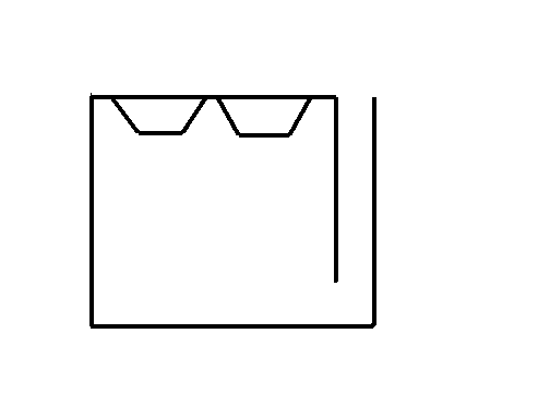

I have never built a slot ported box before. If I were to build one, would it be ok to build on similiar to the one I am attempting to diagram below...the inside port wall will prolly be about 12 inches or so long and 2 inches wide in abox that is like 25 inches long...or am I way of on a the general structure of a slot ported box (does there need to be more then one port wall)?

Thanks Ed, that is it!!!!! ....my port will probably end up being only about half the legth of the box (because the box will be long).
...anywayz, does anything seem wrong with that setup?

I'd probably do the port in the center, but that's just me.

Yeah, me too...but I need every inch I can get...and that would make the box longer.

that boxplan works like a champ, and is very common. if you decide your port needs to be uberlong, you can fold it, like in this picture:
