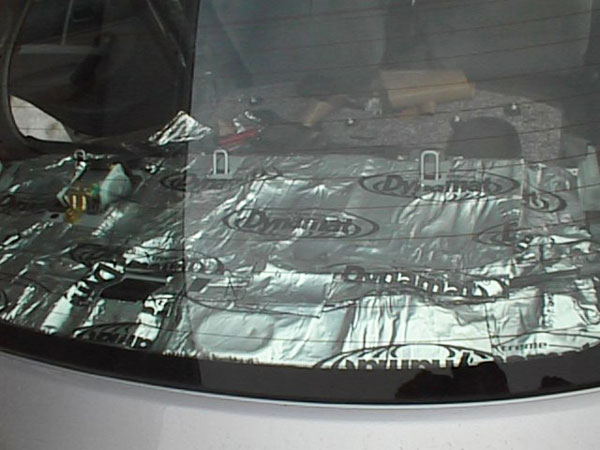

Ok so I'm one of the many wanting to get rid of my rear deck and trunk rattle.Well a few month ago I took off my trunk lid and put dynamat extreme on it and thats fixed so I wanted to move to my rear deck today! Well I gt everything disassembled and put on a layer of dynamat (Pics Below),It wasnt totally pro looking due to having to cut small pieces to fit correctly.Well I also got my Black balogna and rattle pad from second skin audio.So I took some 3m adhesive and put on one big peice of the black balogna and tok a strip of rattle pad and put it where the deck meets the windshield.So all is well and I try to reassemble! BIG problem Anything thicker than a lyer of dynamat and the deck pins cant be fully inserted! So after a huge hassle of trying to fit it and cutting my finger all up I have to tear out the black balogna stuff and rattle pad =(, and end up breaking 3 of the deck pins in the process =(.Well I left the dynamat extreme on and managed to get the deck back on and car reasembled.Took it for a test drive and blasted the system at full volume with sub pounding and NO vibrations =) all I hear is a lil air escaping from some cracks.So after all that I acomplished my mission. Next week I'll save my self the trouble and put some Cascade audio spray n dampened to the underside of the id in the trunk and seal everything up nice and tight! BTW my bass is noticably louder too =) PICS BELOW

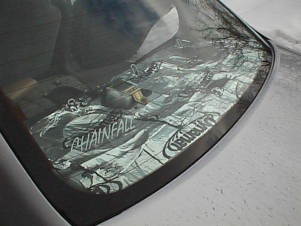

dynamat 2

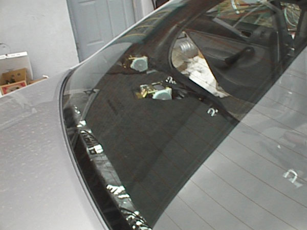

Black balogna
