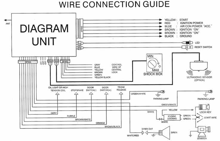

Alarm/Remote Wiring
biggest problem: trunk release wire??
acturlly.. i gotta find out those wire too:
START
IGNITON POWER
AIR CON POWER (ACC)
IGNITION "ON"
IGNITION "ON"
GROUND --- <Black>
OIL LIGHT OR HIGH TENSION COIL
STOPBRAKE
DOOR SWITCH (-) --- <White/Green>
DOOR SWITCH (+) --- <White/Blue>
TRUNK RELEASE
PARKING LAMP
ENGINE LOCKING --- <Ignition Harness>
LOCK KEY --- <Ignition Harness>
STARTER --- <Ignition Harness>

Our cars dont have a remote trunk release wires. I think you would have to get one from a 98-02 accord.

I have trunk release! =D My alarm has a trunk release function on it just so that if a car already has remote trunk release then I could just wire the alarm into it so I won't have to carry so many remotes around. Anyway... Yes our cars don't come with trunk release. What I had to do was go buy a trunk release solenoid and wire it into my alarm. Works out great. Should only cost about $30 or so at a car toys or good guys.
