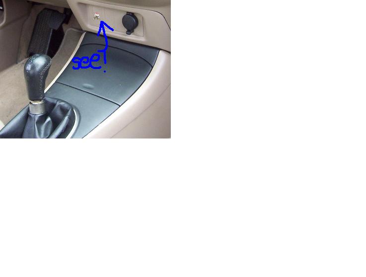

yeah if u got any more q's PM me, i have shocked myself multiple times so i could tell u what to do and what not to do...
Name:	switch w wiring.jpg
