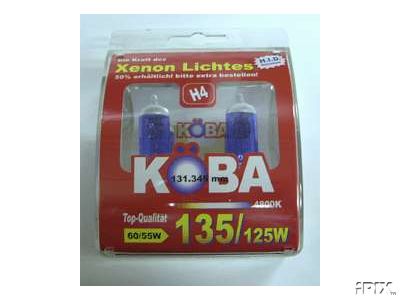

Here this is what I bought...these are 135/125W correct? So I guess I shouldn't put these in my car... dammit

those look so cheap. but i think they mean they draw 60/55w and put out "135/125w" light. look on the base of the bulb, it should tell you the actual wattage
Yeah, I agree. On the case it says 60/55w. I think that means they are as bright as 135/125w bulbs. You should be fine.

You are fine, they are 55/60W =)
