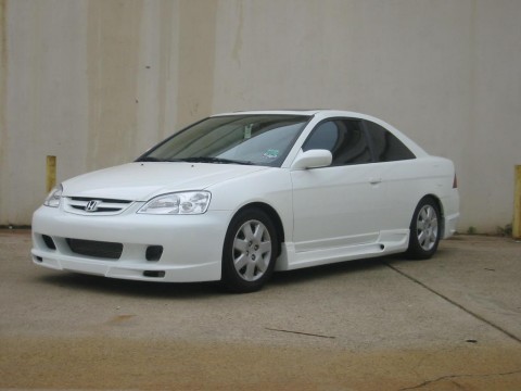

i'd say do it yourself, i have the full kit which includes the full front bumper. As for the sides and rear the part that flares up along the door has double sided tape on it and your gonna have to jack your car up and use the many screws provided to screw and secure the kit from the bottom as well as 1 screw on the front and 1 screw on the rear of each side skirt. As for the rear you need 2 screws per side and the tape will do the rest. It took 2 hours doing it by myself and i used 5 screws to secure each skirt underneath the car. *****BE SURE TO MEASURE IT PROPERLY B4 YOU TAKE THE TAPE OFF!!!!! because if you dont do this right its gonna catch the door when you open and you have to redo everything. HTH
