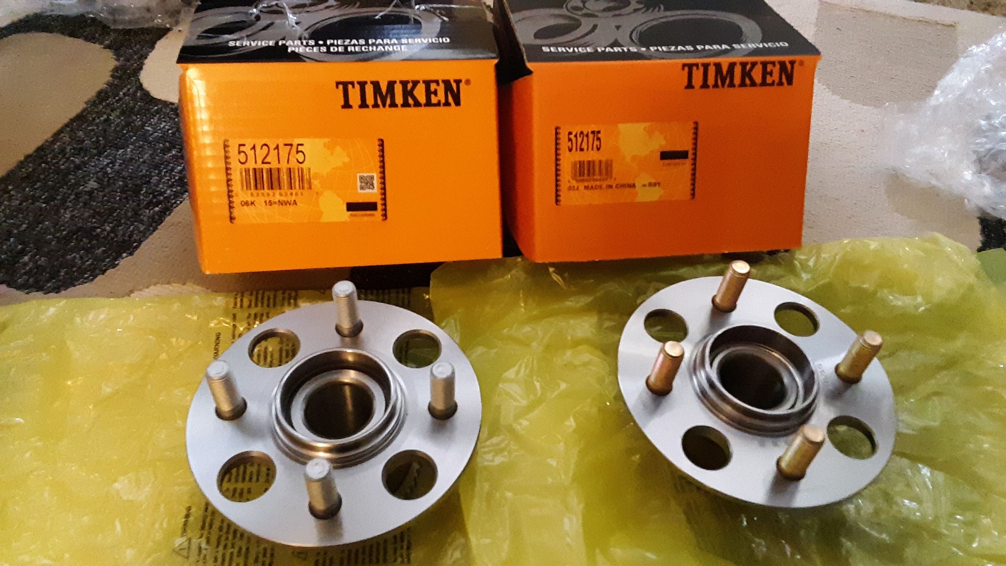

Just received an order from RockAuto for rear brakes and bearing assemblies. All was good except the bearing assemblies were different. They are both the correct part #, but the design is different.

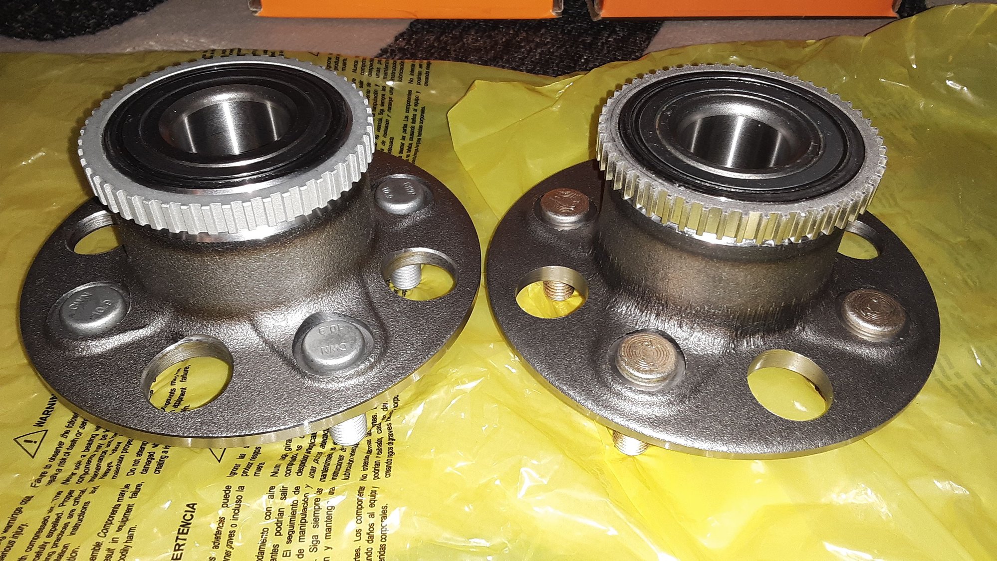

One design is the typical Timken bearing that I've seen before. It's one solid casting, OE flange thickness, and smooth bearings with obvious seals. I can't find the country of origin, but whatever it is it appears to be of good quality.

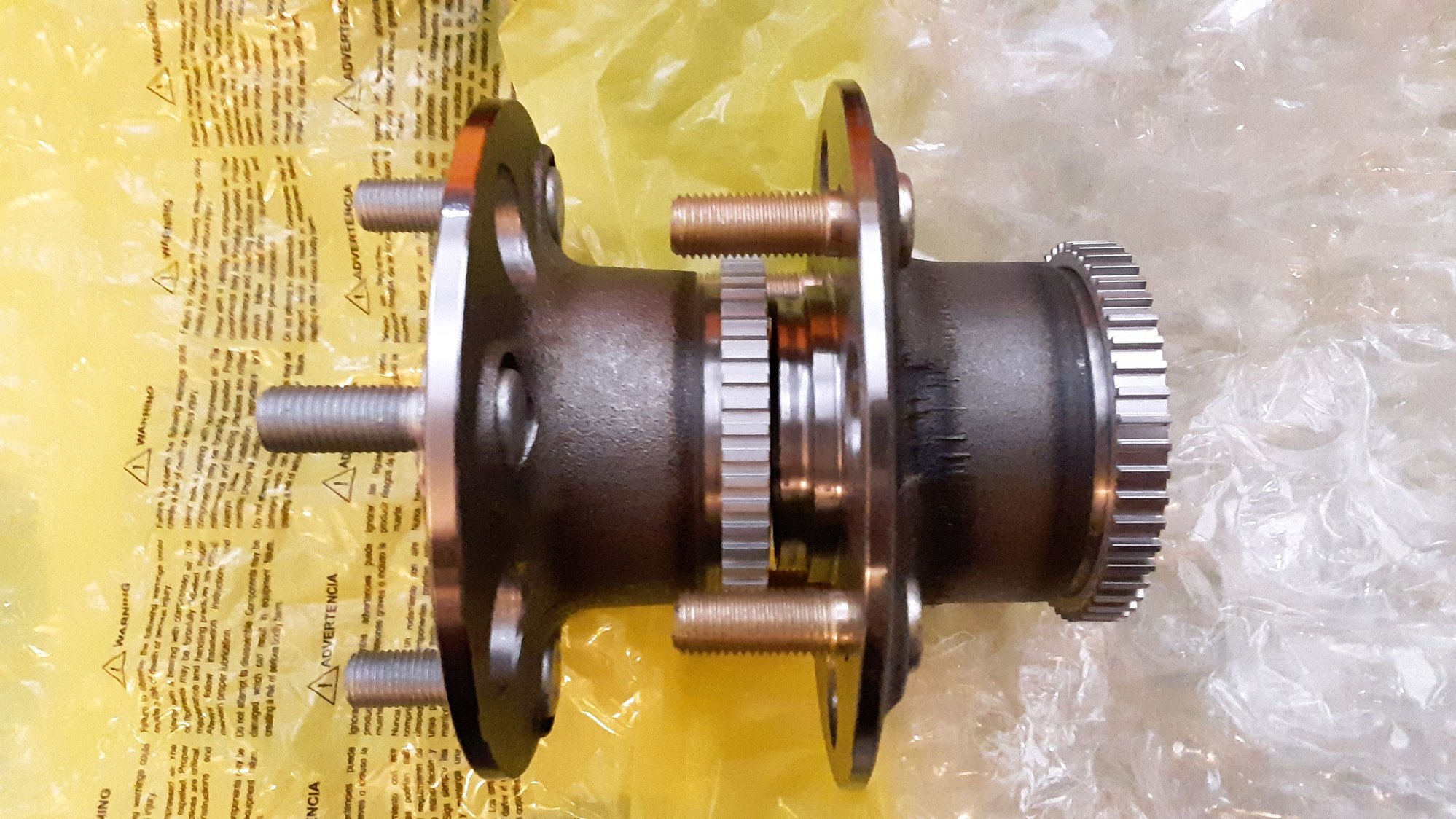

The other design is made in China (stated on box), the flange is thinner, the housing appears to be two separate halves welded together, and the outer bearing half seems gritty and missing the seal.

Different flange thicknesses:
Solid 1-piece casting vs welded 2-piece ?? Also, different ABS toner ring.

I received my replacement bearing today...faster than expected. It appears to be an authentic Timken bearing almost identical to the one I kept. The only difference is that this one has "Timken" etched into the hub face along with some other code. The other one has no markings at all, anywhere. But, both look good and I'll be using them when I do the rear brakes.
I should mention that on RockAuto's website there are several lower quality bearings available that have the same part number as the Timken. I believe they put one of those bearings in a Timken box and sent it to me. The etching on the hub face did not say Timken on it, but rather the P/N with a 'W" in front. It may have been a WJB bearing assembly.
