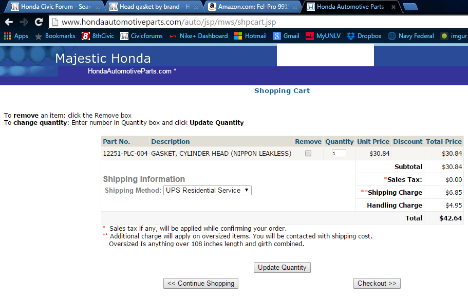

I personally would have spent the extra $8 for Honda OEM parts, but that's just me.
