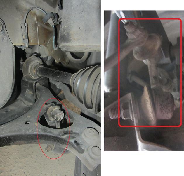

Hi,
I am looking for a part for my Civic Sedan 2009 LX 4DR which I don't know its name in English and its part number!
The picture is attached...
Anybody can help me please?

That is your front sway arm end link. Also referred to as front end link. There are 2 one on each end of your sway bar.

#14 or 15, for right or left .
You probably should obtain a set of new nuts also, just to be safe.

This is in Knuckle category? I cannot find it @

Your link has the same picture I just posted.
Old Nov 1, 2012
Re: Looking for a part
And #18 is the bushings you asked about in the other thread.

hey buddy, you link does not open for me!
so if the picture is the same, which number is this part?

Ok then, this is YOUR link: http://www.hondapartsnow.com/Page_Pr...geName=Knuckle
And the pic from your link:
14 51320-SNA-A02 LINK, R. FR. STABILIZER $18.57 $13.46
15 51321-SNA-A02 LINK, L. FR. STABILIZER $18.57 $13.46
You should need two of each of these nuts if you do both of the links (one of each per link):
21 90002-S10-000 NUT, FLANGE (10MM) $2.57 $1.86
26 90212-SA5-003 NUT, SELF-LOCK (10MM) $0.55 $0.40
And the compliance bushing
18 51391-SNA-305 BUSH, FR. COMPLIANCE $16.50 $11.96
You may need to use a proxy server to get around site blocks in your country.
HTH

Number 21 & 26 should also be changed?!

I sometimes have to CUT the nuts (or the links) off in order to remove the links. Easiest to already have new parts before you discover you need them.
