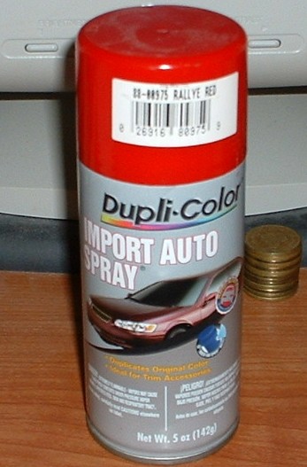

duplicolor makes premixed spray cans of oem colors. They have most of the 7th gen colors (i did not see green or gold).
i sprayed a few black pieces on my car (dx comes black unpainted trim
Rallye red is a flat color though. The only thing i had to worry about was the right amount of clearcoat.
Make sure you do your homework on spray painting (prepping, sanding, primer, layers & coating, etc) or it could turn out real bad.

Ehhh... I just feel a little uneasy about spray-painting my car.
Old Oct 3, 2006
Kevbotron's Avatar
I like my commute
Joined: Apr 2006
Posts: 3,237
From: New Hampshire
Rep Power: 277
I think a can like that would be fine for something like side view mirrors or door handles (dx) I dont think a full body paint job should be done by anyone w/o previous experience painting cars.
and i was just posting another option not everyone has the same knowhow, skills, abilities, &/or supplies available to them
