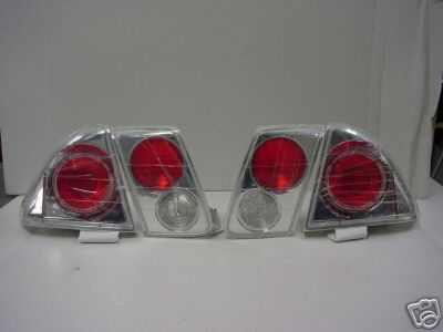

I just bought some Rear lamps. They are the one's that have halo's. they came with two wires with "male" ends on them from each halo. How do i get the halo's to work? were do i put the wires?

i assume you would wire the positive wire to a 12 volt source and ground the other one.
Old Sep 20, 2006
Rep Power: 812
first determine which is + and which is - by hooking to a 9v battery. once you know that, there are several options. you can have them come on with park lights by tapping the power and ground to the small parking light wires. or you can have em only come on with brake lights, just hook the power upto the brake bulb wire. its easy whatever you decide. which tails do you have? pics?

Pic of lights
Here is a pick of what they look like.

so do you want the halo to come on with park lights? if so just tap them to a parking light with power and ground. that middle circle one is a park light i believe above the reverse light

Do i have to splice the wires? how would i tap them? i have never had to do this before. yes, i want them to come on with the parking lights.

they sell the wire taps at auto stores, but really its easier to just cut off the plastic cover of the wire you want to tap so the actual metal is exposed. then tightly wrap your exposed halo wire around it and tape up everything tight with electrical tape. do not cut the wire by accident, you only wanna trim off the plastic around it so you can connect your halo wire. a utility knife works well but be careful.

For all those who are thinking about putting on Halo rear lights...DON'T!!!!
It is a waste of time and your money. i will post some picks soon to show you. They are a rip off. Guess i learned my lesson.

so im guessing they are barely visible? i kinda assumed that looking at em. i actually had to redo the leds in my projectors and its still only visible at night in pure darkness. hey can you check the tails and see how they are sealed up? like do they look like stock where the plastic is melted together, or is there actually some sealant between the pieces. you could be able to take them apart and wire in some more leds to make it look good.
