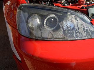

liquid cooled headlights
anyone else have this mod?

hehe crack them open and reseal them..

yeah they dry out when its warm but they have a light film resadue left on them. im about to get another set but they are such a eye sore to look at!

happened once on my tyc lights t
hen during the 3 week rain storm it never happened.
Never resealed them

I used to have that mod. But I swapped it out for perma-sealed headlight lenses. And I've never looked back.

have that mod rite now... only da right headlight

Anyways, one quick fix... take the rubber groment off the back... the part around the back of the bulb. Letting air in and out will allow it to dry.

^yep.. that will let it dry out.. to get rid of the film yer gunna have to crack them suckers open... or do it ship in a bottle style which will take you about a week (aka q-tip on a stick poked through the blinker hole).... then tape off the edges.. get some silicone.. goo them up and before it dries remove the tape.. you will have sealed headlights and a nice clean sealing job..
to get the lights open use the clearing headlights diy in the lighting forum.. ... a lil bit of fog is a standard on basicly all aftermarket headlights.. but thats a bit much..

couldnt a guy just put clear caulking around the seam before he installs em? just to make sure? least amount of work.

^ yep.. thats how i did mine.. just by lookin at them i didnt trust the seal.. no point in opening them unless you have to..

HAHAHAHA i was about to flame ... i had the same problem cus i had taken apart my tyc's
first both headlights then just the Right then both now just the left... then nothing at all
